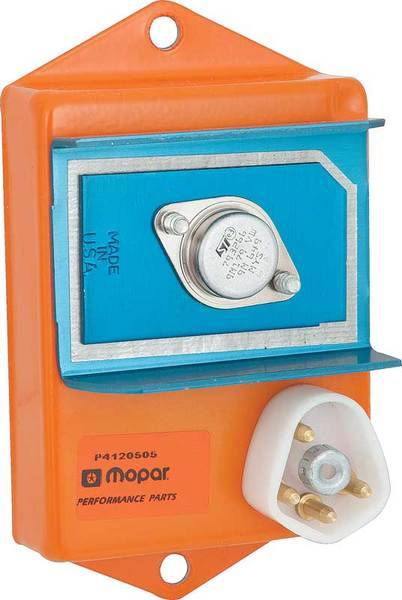

Given that the ignition was converted over to an electronic ignition, does it have a ballast resistor? I don’t see a whitish looking one (like they sell at the auto parts store) near the distributor or on the firewall.
Mine does, but it is a Mopar Performance system. I think some (maybe MSD) do not use it.
That diagram I posted shows the system with the 4/5 pin standard mopar electronic ignition. If you have the conversion using that style, this diagram should be exactly what you have. If you see anything like this with your system, it is what they used. If they used MSD or another aftermarket unit, they sometimes are internally regulated and do not use a ballast resistor.

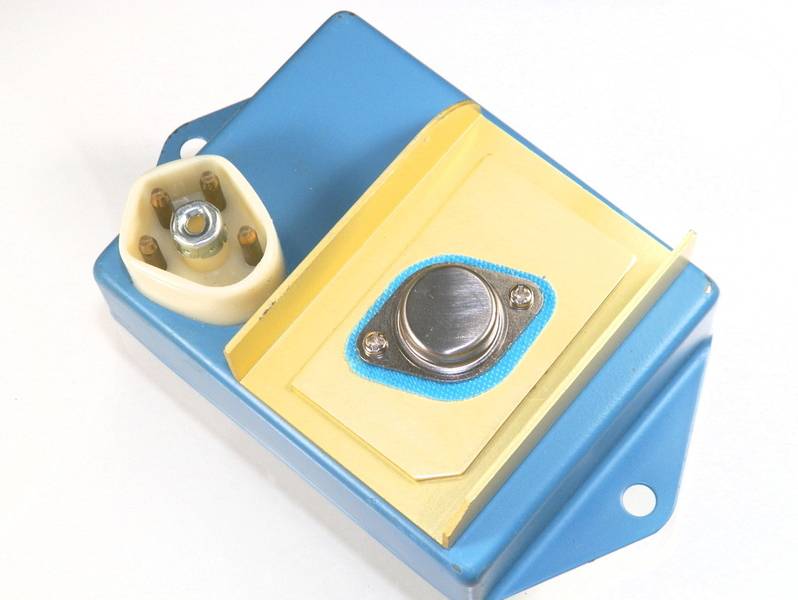

I’m using the silver control module, pictured above. I’ll follow the wire coming from the number “1” in your diagram and follow it to the ballast resistor. I’m thinking I should start with that before checking the ignition switch. Agree?
I had converted my 63 to electronic years ago before some the newer systems came out. One time when it wouldn't start it was the box pictured above that was bad...new one and started right up. After having gone through other components, ballast, etc. Not to get too fundamental, no spark or fuel most of the time. Check to see you got spark at the plug during cranking...if you find no smell of gas putting your sniffer near the carb after pumping and cranking a few times then it could be no fuel reaching the carb. No ballast...or box yeah sounds like a different setup as posted..
Yea just make sure you have 12V on the run side of the ballast going in with the key on. If you dont, then follow it back to the ignition. If you have power there, I would change the ballast out and try that. You can test the ballast resistor with an ohm meter as well just to be sure.
