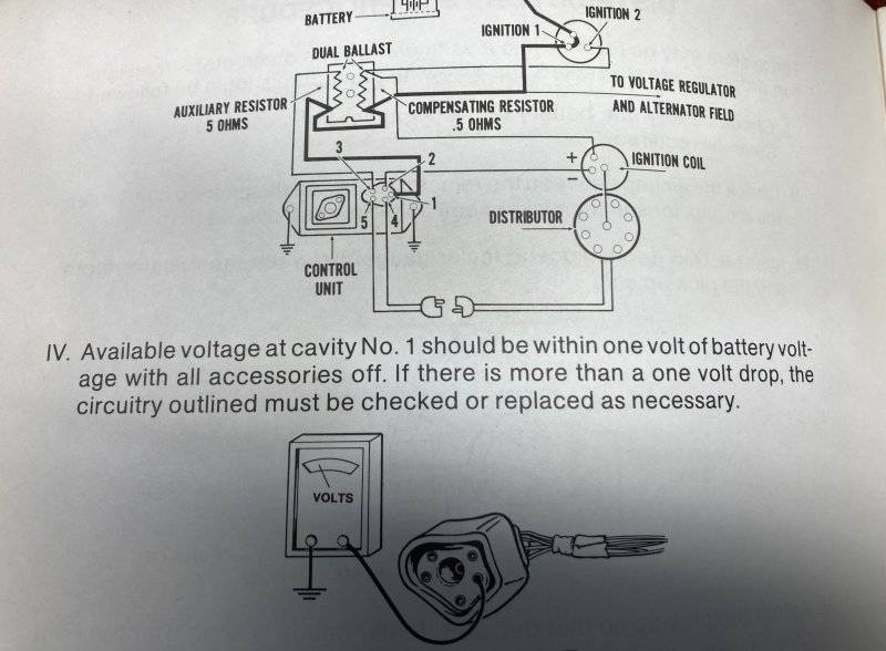

So I'm at the same place. I was going to disconnect the connector to the ignition switch and see if I had 12v (or power?) on the red wire on the connector from the bulkhead to the ignition switch. Then take my multimeter and turn the key to see if I have continuity during the key / ignition selections on the connector from the ignition switch. Someone please stop me before I rip apart the column. :) Thanks!!!

So it failed the Primary Test A and says that the circuitry outlined in black must be checked or replaced! Back to under the dash! That manual is great!
