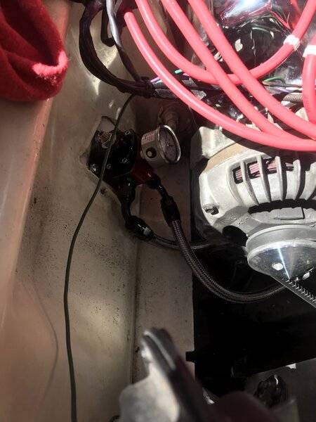

Heres an update on the cross ram:
I am installing a fuel pressure regulator - I think I have high fuel pressure and its confounding my efforts. I got it mounted but need 2 more fittings to connect it (waiting on UPS). As soon as thats in Im starting a designed experiment to dial in the idle. Its 4 factors/16 treatments full factorial. I will report!

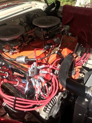

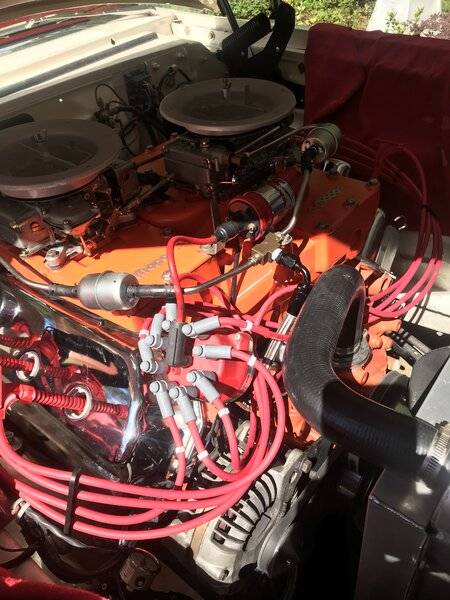

cross ram update:
Fuel pressure regulator on!
Timing set
Will take for a test run today
E7BE2A4C-4A9A-40B8-9857-F0929D7B65DC.jpeg 3ED53B9A-053B-473C-8719-6FFFBF91DBF3.jpeg
I was hoping to hear how the car ran. I am not staying overnight but I may hit that pizza shop on my way in or out. I run 6psi on my set up. Works well.
I also set 6 psi
It runs MUCH better!!
