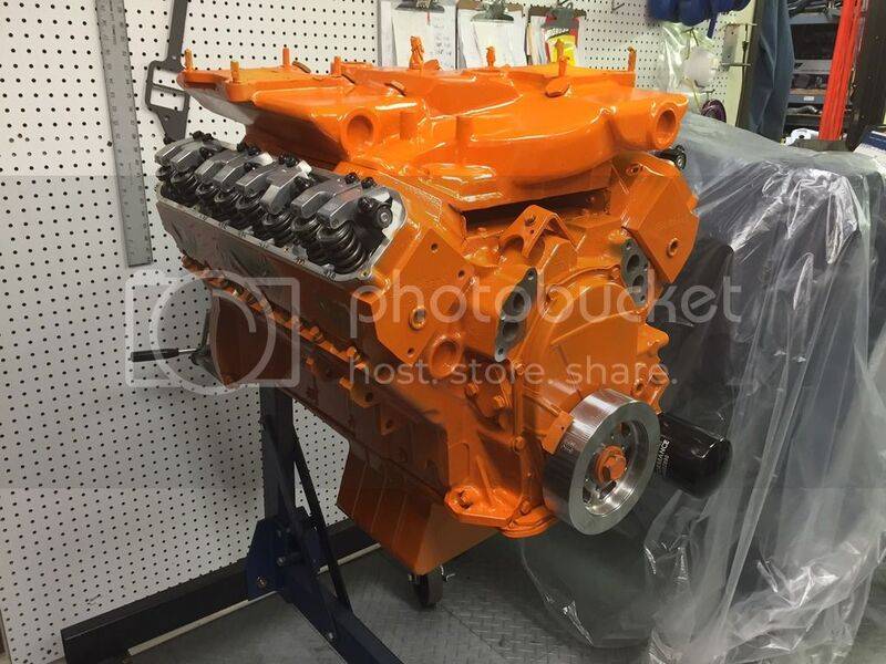

The engine is a 540 cu. in. with Victor Max Wedge Heads. Compression is 10:1 for pump gas. Cam is 648 lift solid roller. Carbs are 750 Edelbrocks.
Looking for a starting point. Should be putting it on the Dyno within the next month to tune it and see where the numbers come in at.
Also was curious about which jets to change based on burn in different cylinders. I have heard about all kinds of funky jetting for these intakes but hopefully someone can help educate me so we can get it dialed in while on the Dyno.

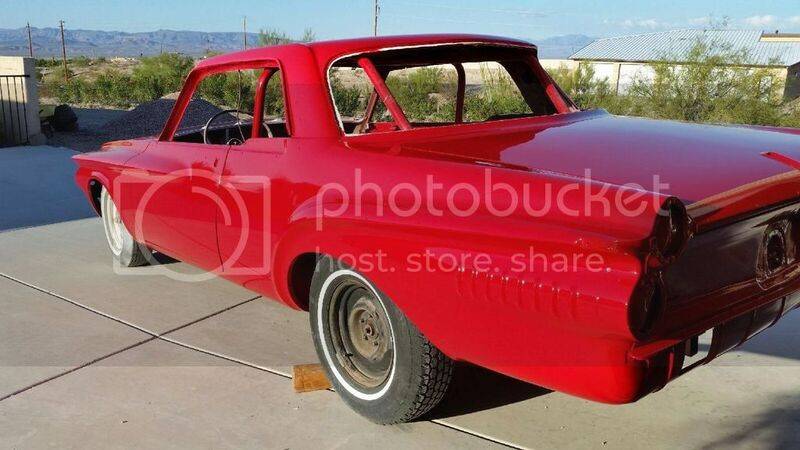

Ohhhh this will be going in my '62 Dodge that I have been restoring for 6 years now and its finally getting close. Hoping to be driving it this summer!
