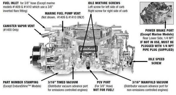

Jordan, first thing I see wrong is the pcv port going to your driver side breather without a pcv valve. That's not going to work good at all. Hooked up that way, your engine is getting unmetered crappy air all the time. This could be half your problem. When you go to start your hot engine, the crankcase is pushing all that crappy air into your intake. The blowby is waste gasses, that has very little oxygen and a lot of carbon monoxide. A pcv valve is a spring loaded check valve, it only meters a small amount when there is sufficient vacuum to over come the spring pressure.
I had a old 318 that would fill the engine compartment up with blowby when cranking hot. This car drove me nuts. I would open the hood, check for fuel and scratch my head!? Get back in the car and it would start up after cranking like it was flooded.
