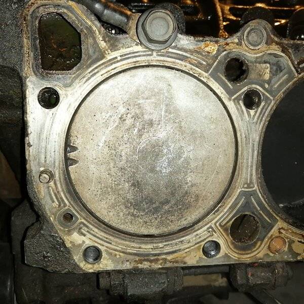

Factory car pistons are flat tops +/- .060 down in the bore.
Does it need bored or can it be reringed...used 361 pistons are around to if you don't have any, any b rod should work.
The Egge piston I saw was listed as a flat top with a 1.89 compression height. Part number L2079-8
Nominally yes, but I am getting more than that. I have been using a straight edge and stacked feeler gauges, I've got to find a better way to measure.
If your responding to my post, the .045 is theoretical based on spec numbers not measured numbers.. If the deck height is proud or the rod has been resized things vary...
Typically I find the straight edge and feeler gauges gives a pretty accurate number usually within a few thousands..
