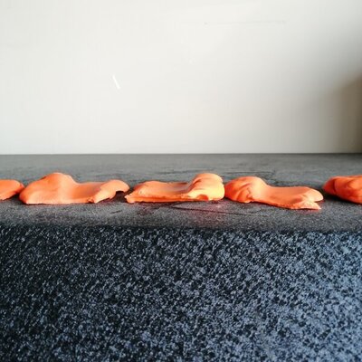

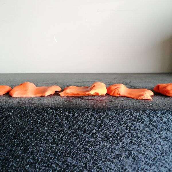

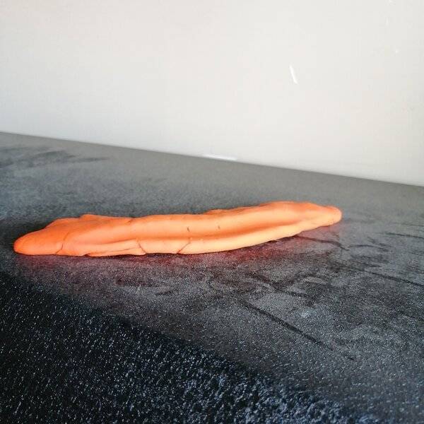

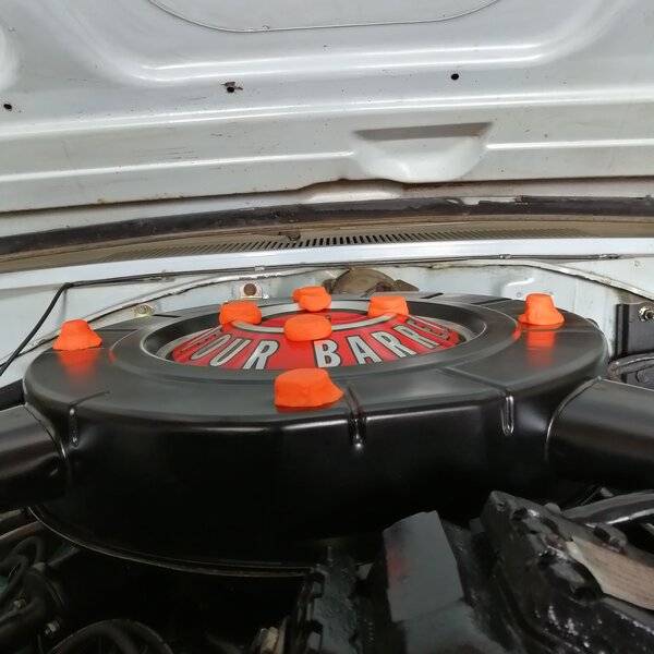

I decided to double check my hood clearance with the 1/2 inch spacer, so I got out the play dough. Everything looked good until I got to the back of the air cleaner right below the rear hood bracing. I only had about 1/16 clearance. Off came the 1/2 inch 4 hole spacer and on went the 1/4 inch fiber gasket. Now I have a bit over 1/4 inch clearance minimum. I readjusted the linkage, good to go. I still need to check the timing and make a few carb adjustments, hopefully tomorrow.

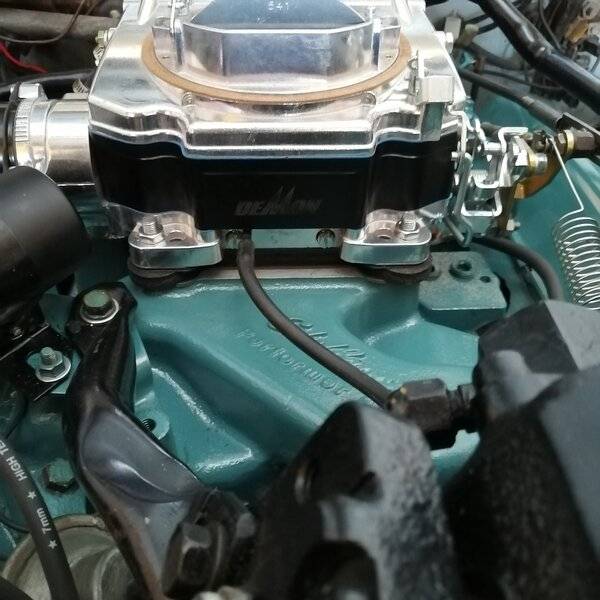

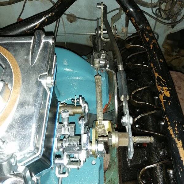

That look's like a good choice. Been thinking I need a different carb. Did all of your linkage and fuel lines hook up ok. Or did you have to mod some of it. Look's good and think your going to be happy. Blue.
I used a standard Chrysler linkage adapter. Hard to say about stock linkage and fuel lines fitting, because my car was originally a 2 barrel so I had to fabricate new.

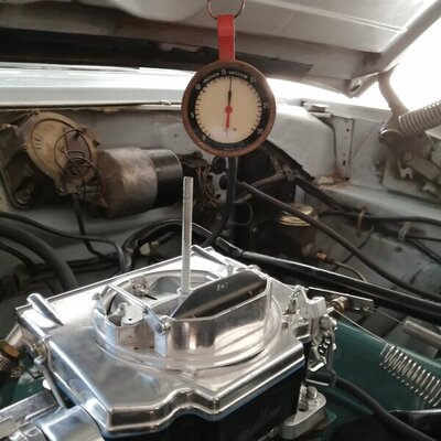

I did a little more tuning today. Hooked up the vacuum gauge and it pulls a rock steady 16 inches at idle. That is interesting because the description of the cam said it would only have 14 inches at idle. I also ended up switching the vacuum advance from ported to full manifold vacuum which cleaned up the idle even more.
