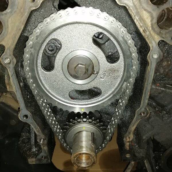

Cam and gear were both changed. Keep your fingers crossed as I will be breaking it in this weekend.
Thats a double roller as long as it doss not piston all fun as hell keep it under 32 full .
IT'S ALIVE!!!!

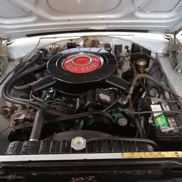

My buddy came over to help break in the cam. It started on the first turn of the key and it runs great. I am very relieved since I previously lost a cam on break in on the 400 in my cuda. I popped the air cleaner back on and now you can't see any of my nice clean engine.

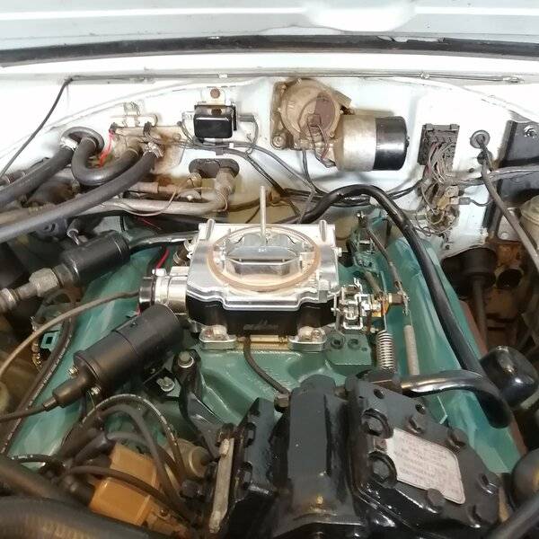

You bet Wolfgang. I found a couple of bad plug wires, so I ordered new ones, and I want to swap the carb over to the Street Demon, but it's running. I was feeling bad about not being able to go to Carlisle, but that definitely cheered me up.

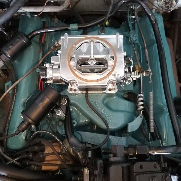

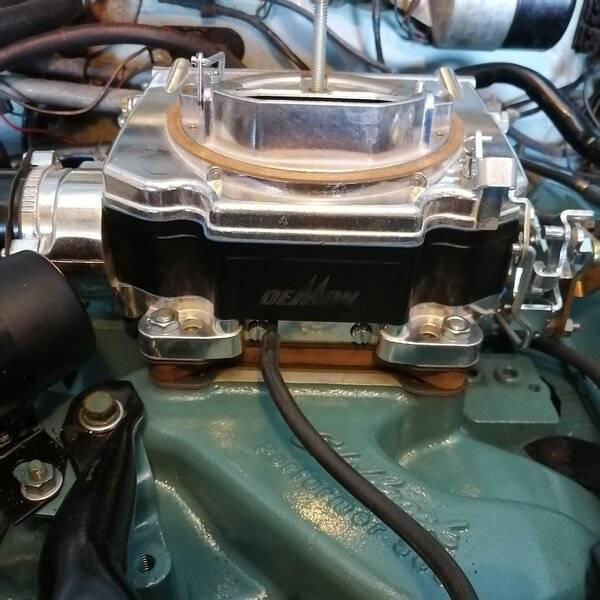

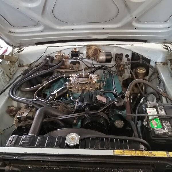

I took the car out for a drive last weekend and it ran alright but the old carb was acting up. It was idling too low and had a huge hesitation. I decided not to waste any more time on it and swapped on the new Street Demon. I took it out for a drive today and it was a night and day difference. The new carb is much more responsive and I can now feel some extra power.

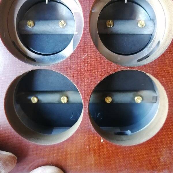

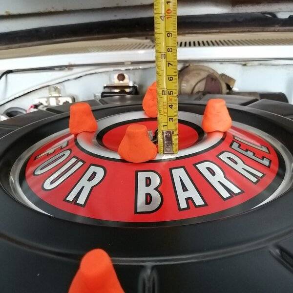

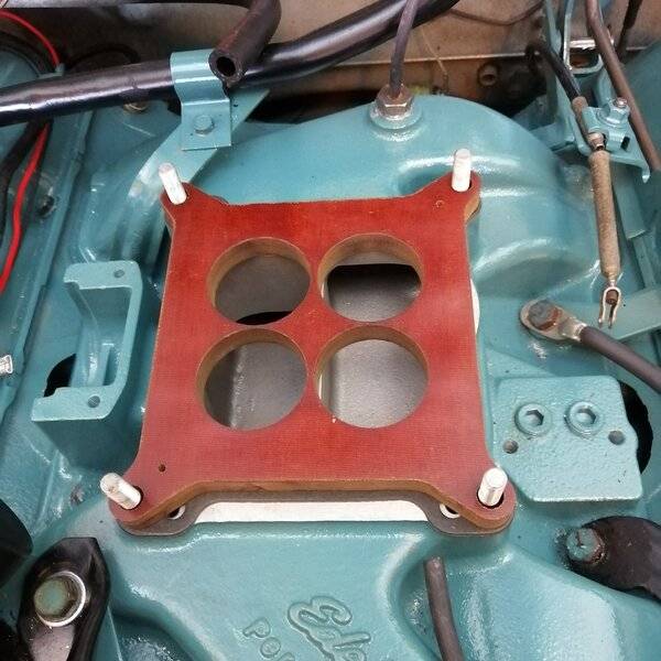

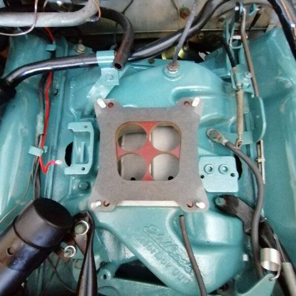

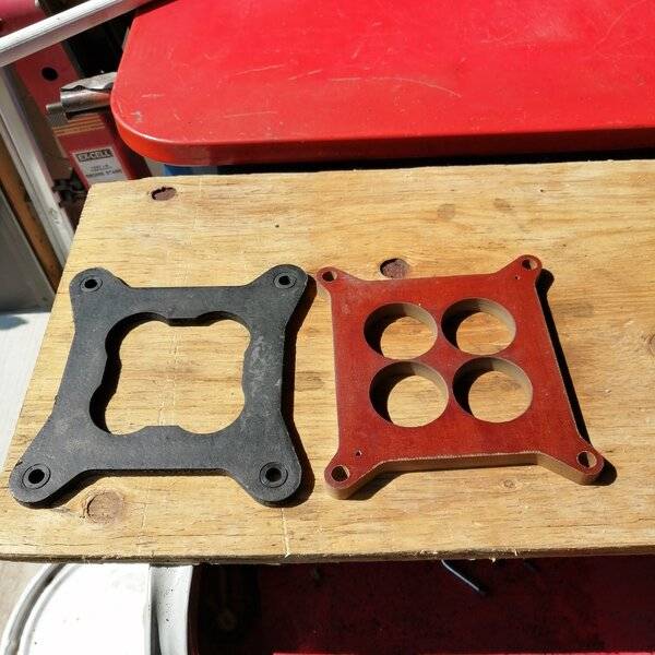

I seemed to still have a bit of a fuel percolation problem so I wanted to add some sort of insulating gasket. First I checked hood clearance, minimum 1 inch. I had two choices left over from my racing days, a 1/4 inch fiber gasket and a 1/2 inch composite four hole spacer.
View attachment 1147294 View attachment 1147295
I checked the four hole spacer and it lined up exactly with the secondaries on the street demon carb, so I decided to use it. We'll see how it works out.
