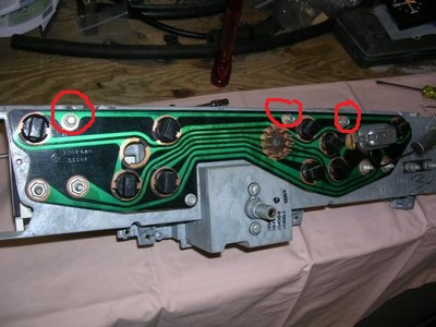

Just add a ground from the cluster housing to the dash frame or cowl area. Oil light is grounded from the oil sender so it does not rely on the cluster to be grounded. If your turn signal indicators work the cluster is most likely grounded correctly.

On my a-body, the screws that hold the cluster to the dash are the ground, so I built a small cluster harness to ground everything to a stud where the dash mounts to the car.
