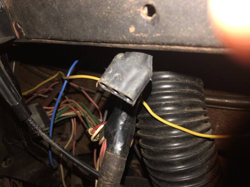

What is this wire for?
thats great Im glad they work. radio plug I think looks like this
It comes off the main harness near what wires for what gauge unless mine were cut not sure why someone would cut them
right side of steering column
