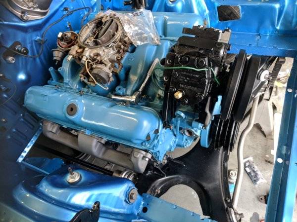

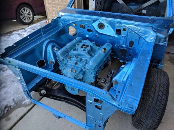

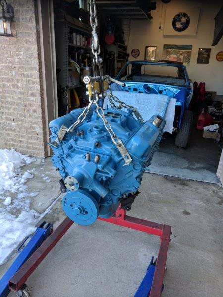

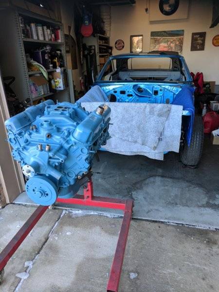

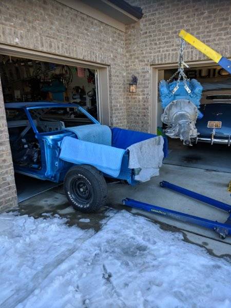

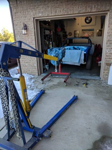

Accomplished the goal for today.... reunited motor and trans to the car.... Someone remind me to tighten everything later...I'm heading for the liquor cabinet...
Good job; also with blue you’ll see an oil leak easily. Sorry just had to say it.
Correct! Did you use the rope caulk around the outside of the foam seal that wraps around the pivot? So when the foam seal meets the cowl the rope seal is an additional seal around the inside hole....
The bolt direction are the only important aspect when installing the mounts and the service manual shows this....
It's a LOT of blue!!!
Definitely need to get some dressing on the motor to break up all the blue.
Drips
Oil
Drops
Grease
Everywhere

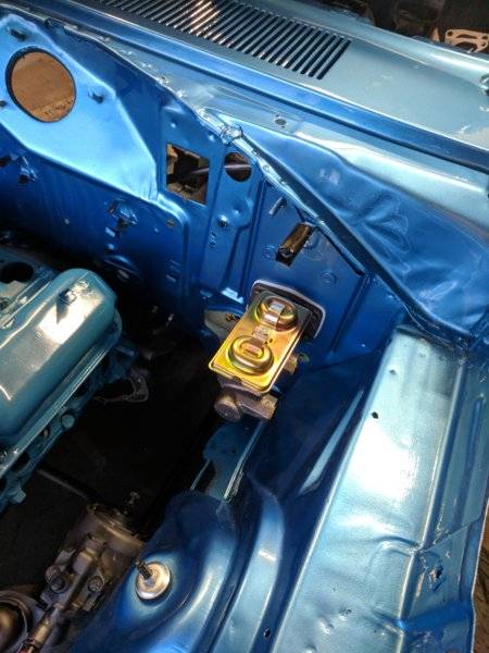

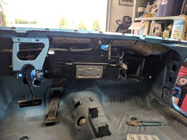

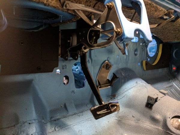

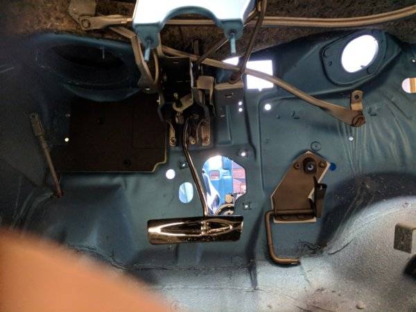

Brake pedal assembly and MC installed
Door hinges back on too.
Tomorrow wiper motor ...maybe

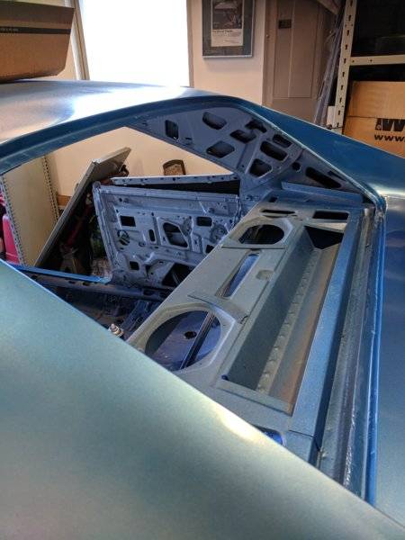

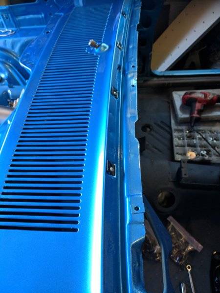

Installed the windshield molding clips, but I need some help on the rear. I have the holes for the clips at the top of the rear (6 of them), but the holes for the sides and bottom were lost with the metal work.
How many clips should be needed for the rear? Same clips at the front (the smaller ones)? Spaced about 6 3/4" apart CL to CL?

They are different and the repops had to be tweaked on Justin's rear window for the trim to work. It may or may not be the same issue as the GTX and Charger may be different. He would know. And it makes a difference in how thick the butyl tape needs to be to bring the glass up to the moulding.

The charger clips are a non issue....if only the Plymouth trim utilized those clips but they didn't and can be used.....
http://www.autometaldirect.com/sout...ld-molding-clip-set-68-70-charger-p-3619.html
Here is a good thread to look at...Bill is good peeps!
http://www.dodgecharger.com/forum/index.php/topic,43619.0.html
5/16 rope seal is the correct size...3/8 will make the trim install a nightmare....be sure to use the primer on the glass that mates with the rope seal to bond....
The corner trim is a PITA....be sure to have the corners on the correct side. They are not the same...one leg is longer than the other leg....

Thanks all. That thread with the blue tape where the clips are is just what the doctor ordered.

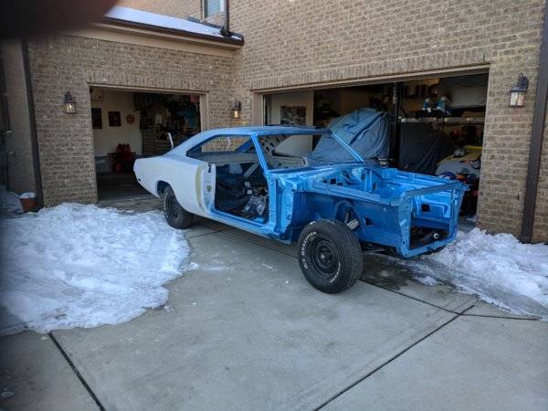

goofed around with various small tasks today as we had visitors mid-day.
Tightened the trans cross member and associated stuff.
Replaced floor pan plugs.
hung the exhaust manifolds, but didn't tighten
installed the high beam switch
placed the wiper motor in place but need rubber pieces first...hardware store Monday...

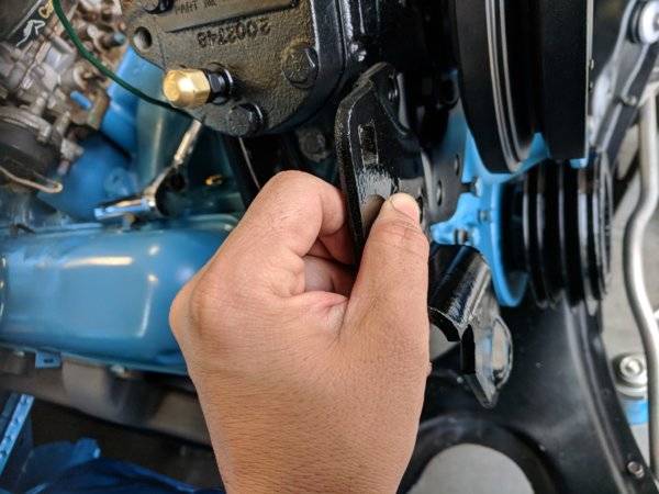

Ok run into another lack of photos nor good descriptions in the shop manual or part manual.

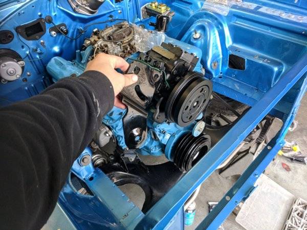

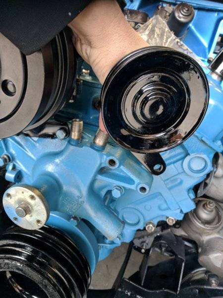

I'm trying to mount the AC compressor back and I just can't figure it out or...
Well I think this with a small roller idler is supposed to go here?
But if that's where it goes, then the bolt was installed backwards by Classic Air. If so how hard is it to take the compressor pulley off??? I really didn't want to mess with that hence why I sent it to be done by someone else...
Then this braket...no clue where it goes...
I'm pretty sure this with the larger idler pulley goes here?
If anyone can help please it would be appreciated. Thanks in advance.

I did manage to get the heater box in... That was a job...I had to have my two boys help with that one. I got the correct gold cad nuts coming from DMT.
Also got the wiper motor installed, need the gold cad nuts for that but for now stainless installed.

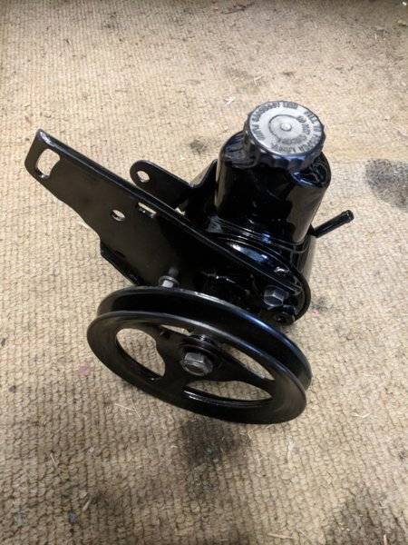

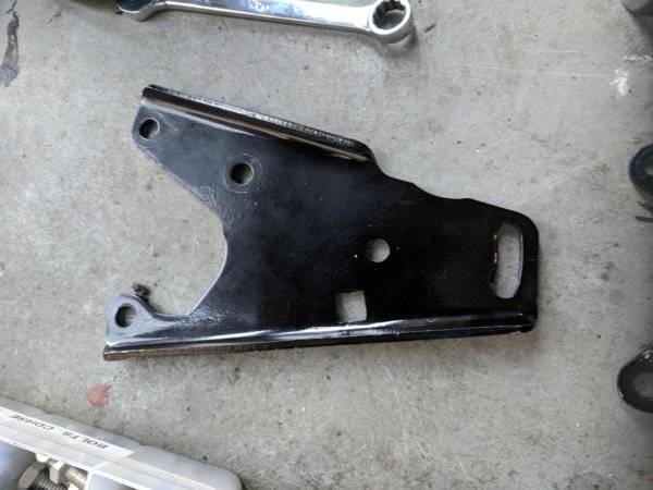

Well I figured out the mystery bracket today... It's for the power steering pump.

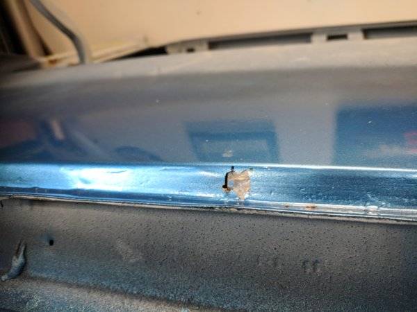

I installed all the clips on the rear, well except that when doing the snap center punch for drilling the holes I broke one repair...
That black line is a hole...so when it goes back to the shop for final paint I will have them repair it again, then install rear window...then paint...so I'm glad I did thing the way I did...would be sick if I was final painted and had to fix just that.
I'm convinced that bolt on the AC compressor is backwards. I have two bolt I took off and kept and only need one now...so...I happen to be flying to Tampa this week and Classic Air is right by the airport...I sense an opportunity...

Brian not sure exactly what your saying on the AC bracket but the bracket is held on with the bolts through the bracket and the nuts are to the rear of the engine. Those brackets are a bit of a puzzle with AC. When you get back I can give you all the photos you need for how all the brackets and bolts go on my AC 318.
Sure I'd love photos. I have some honey-do's this morning, but plan on working on the car this afternoon and tomorrow. I did bring the compressor with me to Tampa (good thing I get my first checked back free) and just had them remove the bolt in question.
