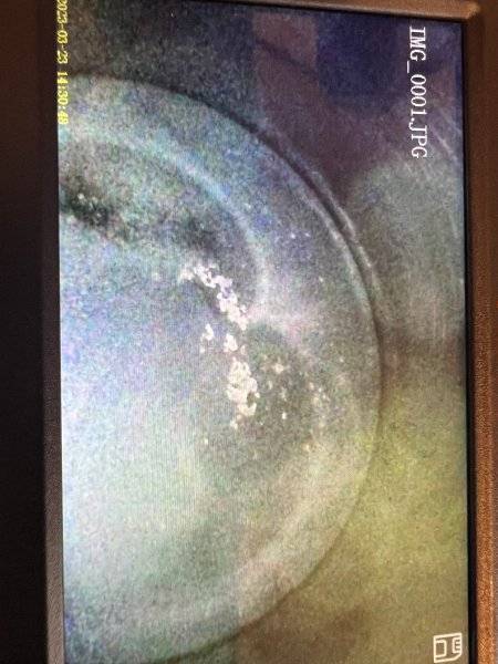

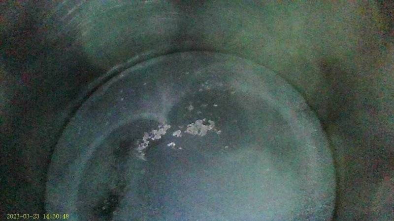

Finally purchased a borescope and this is what I saw. I assume this is due to detonation which I’ve been struggling with occasionally.
Can anyone confirm by this pic?
Probably detonation. When I've had it in the past, the pistons looked like they were shot point blank with bird shot BB's

Not sure, I could hear it occasionally. I picked up an AFR gauge for better tuning this summer to hopefully use it with some timing adjustments solve the problem.

would riching up the carb help with ping.
Yes it can. So can cold air induction, getting the engine to run cooler.
Less ignition timing or better fuel is the answer.

It’s a basically stock engine with a lot of miles and I think compression is down a bit. I put in a limiting plate to reduce total timing and I run 92 pump gas.
Going to install the AFR gage soon as try to tune better this spring.
