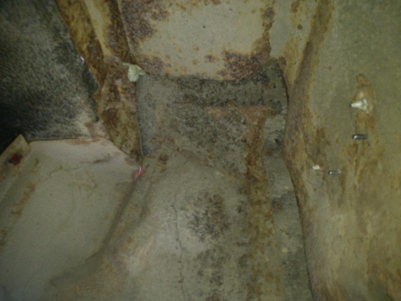

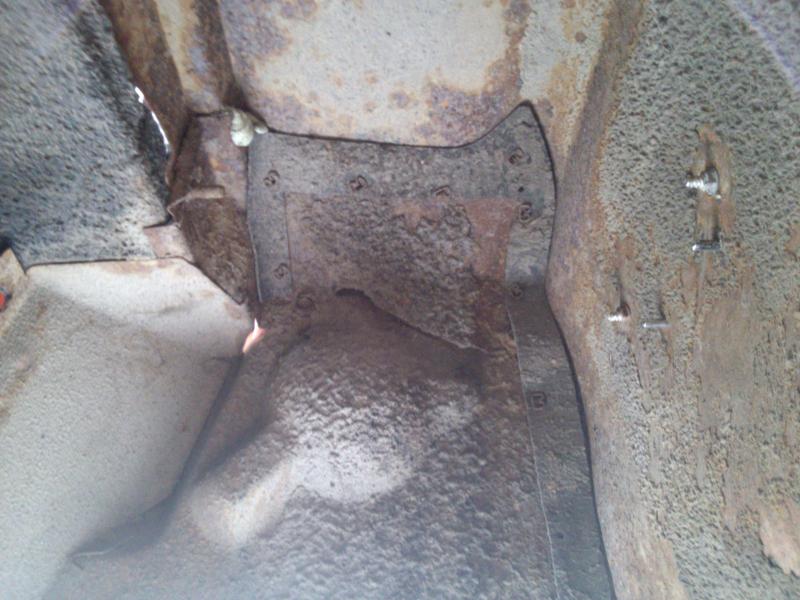

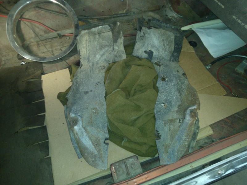

Here's a couple shot's of what i have with my GTX

Keep in mind that there are 2 sets of splash shields, one set behind the headlamp buckets and another that fits inside the rear of the fender below the A pillar. The pics above are a mix of both sets. I believe the ebay link is for the headlamp splash shields. I found a pair of the reproduction rear steel splash shields for a 66 Charger http://www.jegs.com/i/Sherman-Parts/455/171-42L/10002/-1?parentProductId=1912512 that should fit my 66 Coronet but I haven't tried to mock them up yet and see what modifications might be required but they do look like they will fit (being a Sherman part, I am sure they will need some massaging). I have fiberglass headlamp splash shields with fasteners and the rubber edge gaskets that I bought from ebay that fit perfectly behind the headlamp buckets.

For the record, got under my car today and...I have them already. front and back of the front fenders! Yay! Reason why I did not realize it, was I was expecting one of those FULL fender shields...But I guess it was still too early in '67 for cars to have them. So that threw me and I thought something was missing on mine.
I understand that.
That threw me on mine at first too. I never thought they'd leave the top sheet metal of the fender exposed as the wheel well until I took a good look. Check yours over good though, they tend to rust out at the top by the cowl
That's exactly why I started asking..I am going to be really taking a closer look at everything under there.
