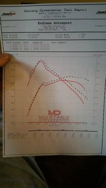

Hopefully someone can make me feel better. I took the Coronet to a dyno days event with the new combo and numbers were WAY below what I would have expected (see photo for dyno sheet). The motor in question is my 526" (4.375 x 4.375).

I know I am handicapping the combo with the carb but I did not expect the numbers to be that low. No way would I ever have expected the max torque to be less than 500 ft. Lbs.
The dyno guys said the numbers are low due to the converter and the dyno can't accurately reflect the true numbers because of the high stall. I watched several other vehicles that I know weren't as built as mine laying down better numbers. Can someone educate me on where they think the problem is? I will run a compression check tomorrow to make sure everything is sealing but I don't think that is the issue. I am also surprised by how low the torque peak occurs.

Very interesting thread. In 40 + years of racing, I've only had one motor, my current one, on a dyno. I always used the drag strip. I have no idea how much difference there is between a chassis dyno and an engine dyno. Those numbers are way low compared to what I would expect. My new 512 did above 690 HP with a fairly small cam, & bone stock 850 Holley at over 700 FT/lbs on an engine dyno. A deep investigation into the motor is likely needed. A bigger carb sure does seem required, but I'd look a little deeper.

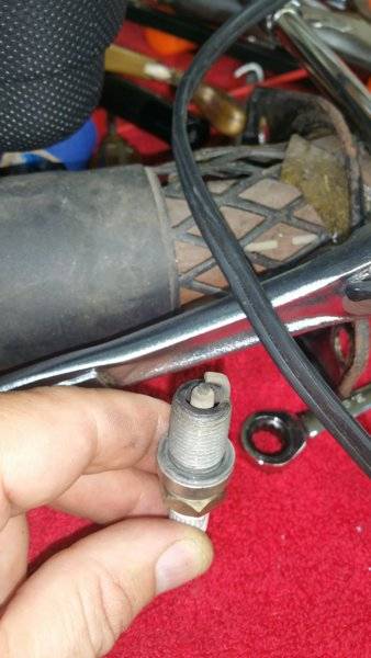

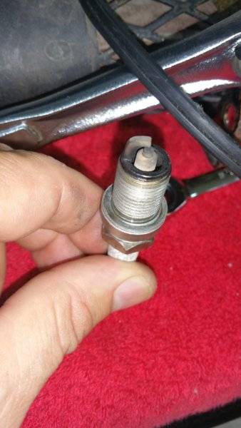

I don't think so but wouldn't rule it out. I just redid the top end with new heads and the short block only has 1500-2000 miles on it. I did run a compression check and leakdown since the dyno runs and everything looked pretty good. I didn't write the numbers down unfortunately but the low on the compression check was something like 187 or 188 with a high of 194. Leakdown was less than 5% on the worst cylinder. There is still a lot of crap left in the exhaust from the prior heads. They were some Stage 6's that were allowing a bunch of oil past the valves. I also had a Wagner adjustable PCV on that day that I did not adjust yet so it could have been pulling some oil when it went to high vacuum when they let off the throttle. Plugs also didn't look bad (pictures of the two worst). I'll take a peek with my borescope to see if anything looks out of place. I also confirmed I'm not using any water from the radiator so there are no signs of head gasket leakage. I am still leaning towards having over powered and blown through the converter, and being under-carbed. The fact that it nose dives right at the expected stall is pretty suspicious.
