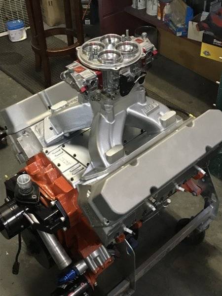

I don’t know what your issue is with a spacer on the Indy, mine looks to be plenty compact with a 2” spacer..:rofl:
:lol: Any taller and you'll need one of those red flashing lights to alert the planes! Actually, I've seen worse. There used to be a guy that ran at the track by us years ago that had two 2" 4-hole spaces on top of a 2" open spacer on a Weiand Accelerator single plane. He had a crazy large cam and claimed it kept the low rpm reversion issues from over fattening his idle mixture. I don't know that I bought it and his ET's definitely didn't back it up.
