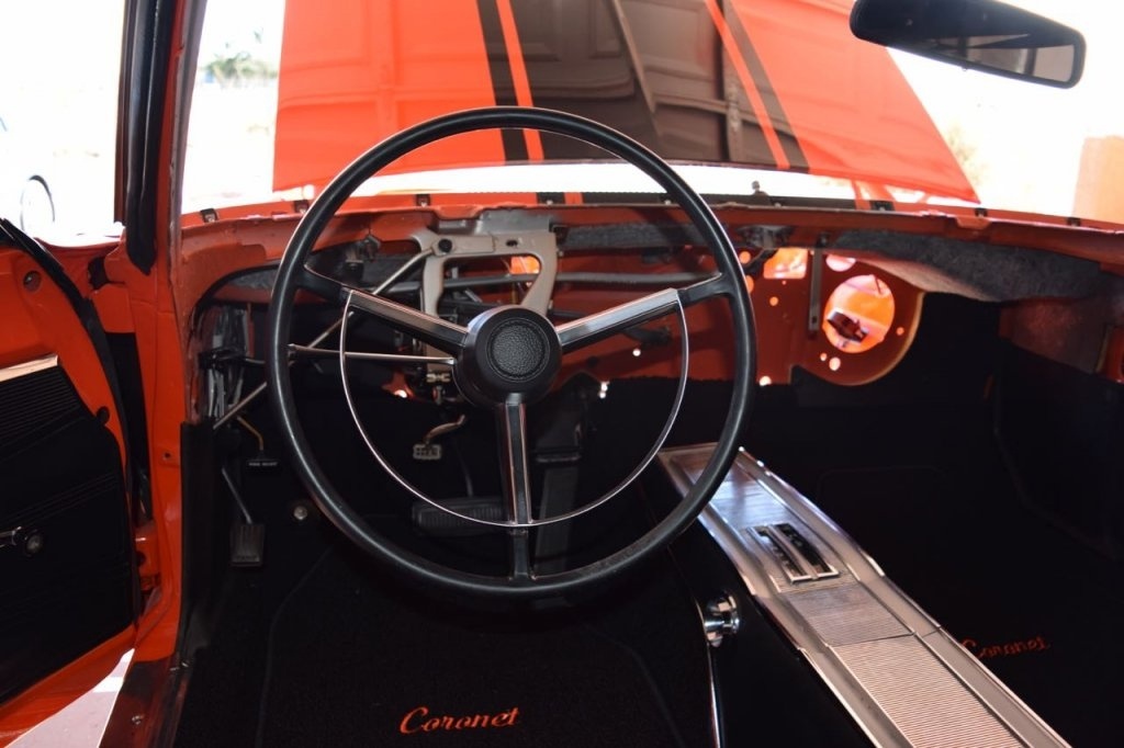

The manual warns of using special tools to disassemble the column on my Coronet. All I want to do is disassemble it enough to bead blast and paint the tube and cover. Are the tools necessary? Can I get it apart enough to paint it without the tools?
Jim

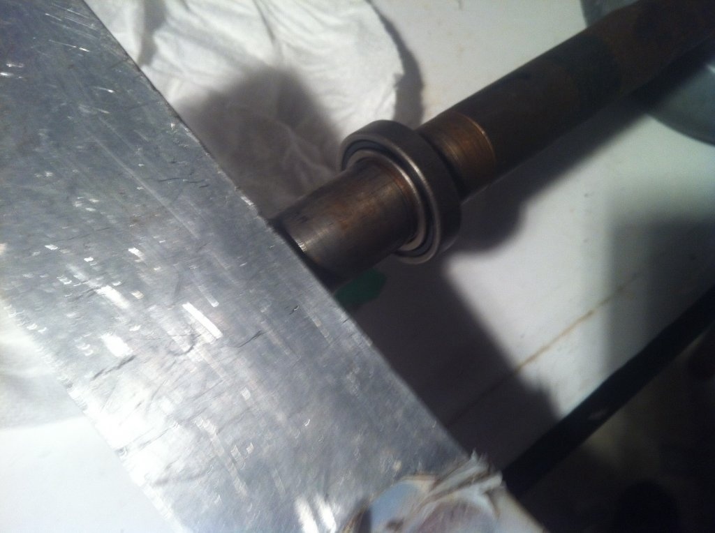

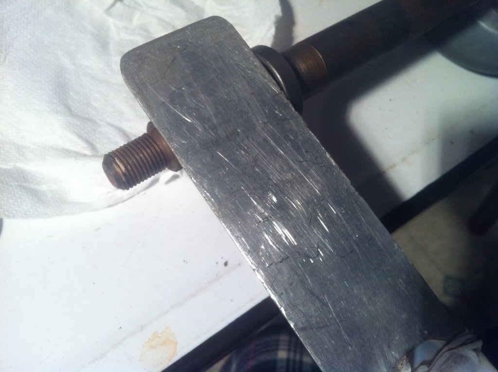

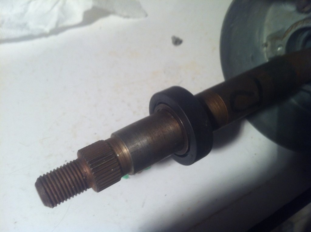

I used an aluminum scraper to whack the new bearing on still available at the dealer < 20$
I just did mine (a few times) using the "special tools", but this may help. You need to be SUPER SURE you don't hit/tap/bump on either end of the main shaft or the plastic "shear pins" (to collapse the column in a wreck) will break since they're super flimsy. I didn't use the special "pin press" to take the lock collar off. I just made sure I had the shaft/column well supported with wood blocks before driving it out with a punch. Pulling the shaft/collar at the top bearing apart can be tricky. My original bearing/seal at the collar just about fell out, but after I'd put the new one in I needed the special "bearing press tool" to get it back apart the second time. So basically, if you can get that top bearing/seal out of the steering collar up top you don't really need the tools.... but they sure make it easier.

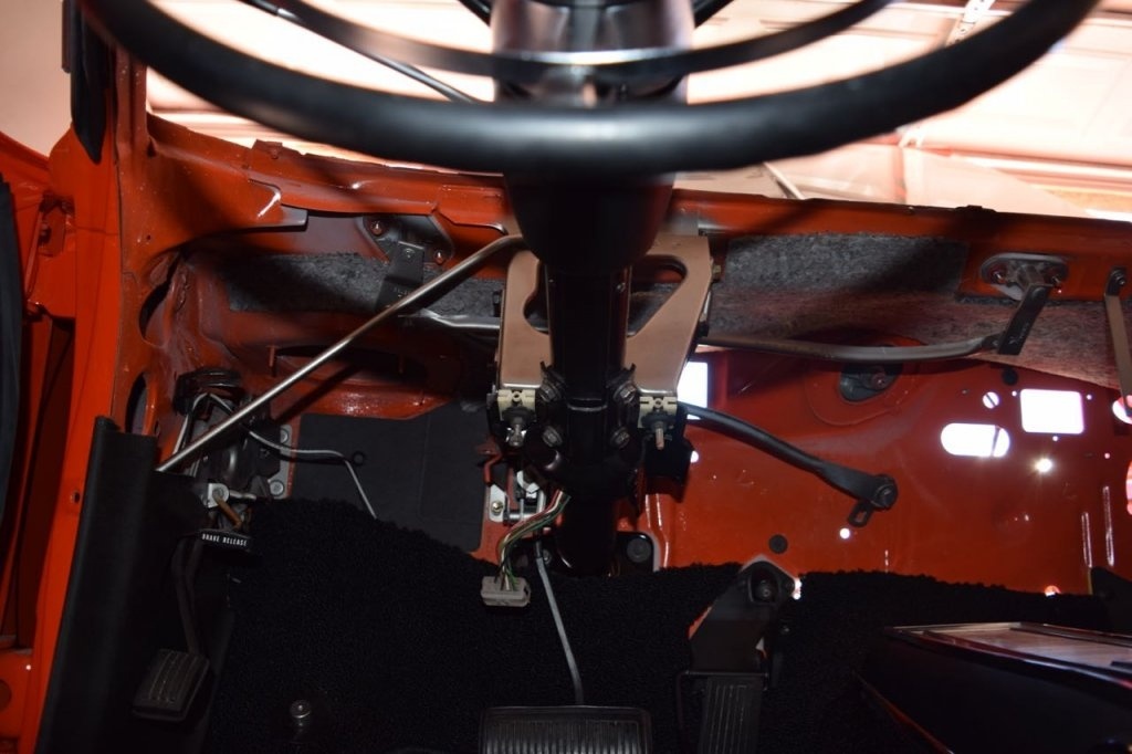

Question on reassembly. When I took it out I unbolted the large flange from the firewall the pulled it out. That was a PIA with the heater box, brake frame, etc. Is it possible to install the large plate in the firewall then just run the tube through the plate in a straight shot when installing the column and then just bolt the small collar to the large plate? It seems like it should work.
You have to pull the wires out of the connector to change a turn signal switch on these cars?! Bizarre....
Yea with the later models they changed the connectector to be a radius so it come through by the tube and collar. On yours you gotta release the wires from the connetor.
