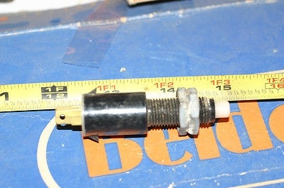

On my 65 Dodge used an adjustable brake pedal pushrod bought this brake light switch on ebay. Had to make a new bracket to align with push rod. The adjustable push rod didn't have tip on the end to reach stock switch. Don't know if this helps.
elps.
