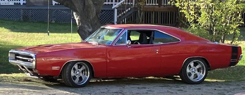

I've tried to emulate the feel I have with my 2007 Ram 1500 into my red car...
Both are 4 wheel disc with a vacuum booster. The truck is linear. The pedal travel is acceptable, the harder I push, the harder they grab. The fronts do lock, the rears are ABS.
The Charger will not lock. Braking is great at low and moderate speeds under normal conditions. It is just that as I press harder, the brakes feel like they don't get any more effective....Like I cross the "tipping point" where nothing I do past that point makes any difference.
