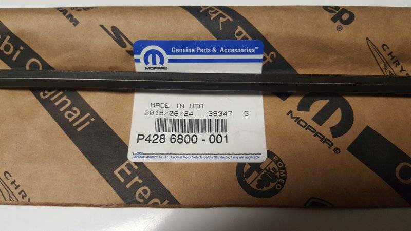

Get yourself a 16" long, 5/16" hex shaft (six sided) and just chuck it in a heavy duty drill. I wouldn't chance useing a socket that might come off and you loose it.
I think I bought mine from 440 Source or maybe Summit. Looks hardened
And be careful because if you have a good drill motor when the pump makes pressure that drill will twist your wrist quite hard.
