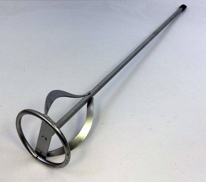

These are cheap and work great. 5/16" hex. I just wrap the shaft with some electrical tape where the bushing would run.
5 mins with a zip cut on a grinder and you have a priming tool for under $10
Hope this helps
