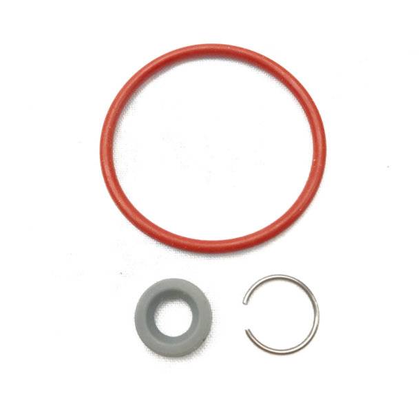

Does anyone have the part number for the 727 speedometer o-ring?

My o-ring is fubar and I needed one yesterday. They are all over online, I know, but I need one quick.
Does anyone have a part number for the orange/red speedometer o-ring shown below?

Mike is right, 2summers ago a shop close to me gave me both seals from a “broke-open” GM kit they had. Worked great.

I was hoping someone had the part number handy, because I really didn't want to spend hours looking up part numbers. Anyways I found it:
OEM Part number: 6025752, 6031370
http://atpautomotive.com/auto-transmission/seal-to-34
The O ring is 1.75" OD X .100" thick.
I wasn't sure about the thickness, thanks. The one I had was 1.75 OD but thicker, so I chopped it down to fit. Well, that only lasted for so long before it started leaking all over my garage.
