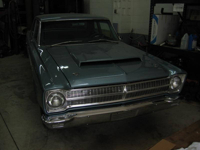

In post #5 I stated that adding the 65 Hemi scoop did lower the temp while driving over the stock hood.As you can see in the photos the entire opening under the scoop is cut out and boxed.
Tom Hoover states in the book "WE were the Ramchargers" that even though the scoops on the hoods did little as far as ram air, it did lower the under hood temperatures.
Not saying that you do or do not have other issues as far as cooling,just that it did lower the temperature while cruising down the road in our case.

Yes, about 10 degrees or so. It was driven several hundred miles with the stock hood and then again with the scooped hood.We ran a 160* t-stat, auto,3.73 gears. Never went over 185* on 90+* day. It has a MP 5 blade clutch fan and a stock big block rad from a 70 E body.Nothing fancy.
