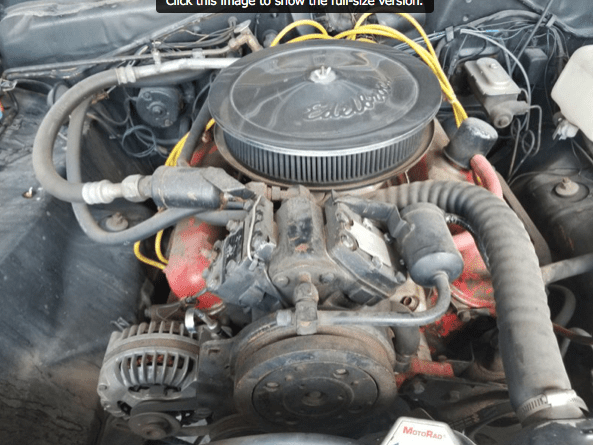

Yep..Your right. I was mistaken on pulley. Pictured is the compressor we took off a '70 440 and used on a 72 318 car. I think the compressor sits a few inches different then it did on the 318 and we changed the line routing some. But it worked.
Thanks for your story. It is nice to know from personal experience that something like this will work.

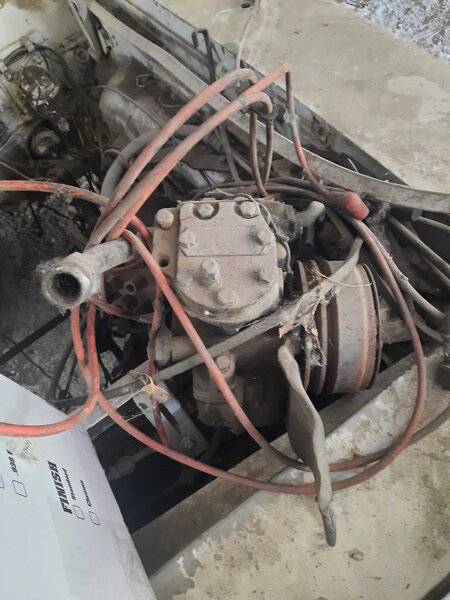

And after posting this... I see a photo that makes it wrong... Not entirely, the application is small block not big block.. But heres a application with a single groove pulley...
Yup... At least two applications... Both of which aren't in my focus... My focus was always performance models.. Only Slant Six car I ever owned only had a slant six while I gathered parts to fix that...
I just remember seeing them. It is possible that the Mopar add on air kits used them on some applications.
