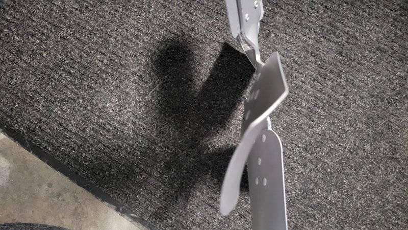

26 inch radiatior, I have a shroud, 19 inch diameter fan, i'll stick in a picture of the fan. The other two pics, I'm trying to show blade pitch, obviously aftermarket fan
I have always had good results with the MP Vicous fan set up. It is a clutch set up and the fan, IIRC, is 19 inches. Also a Flow Kooler or Milodon water pump that has a round flat plate spot welded to the impeller. This was used with ether a rebuilt or new radiator & shroud.
A stock style fan pitch on the blades I think is important. The diameter should fit within the shroud closely with the fan blades inside the shroud. Not beyond, nor just up close. I strive for approximately half way into the shroud. The fan blades should also not be to close to the radiator. While I have seen, read and heard a lot of opinions on the fan blades distance to the radiator, I try and leave about a minimum of a fingers width from the front of the fan to the radiator. This is not possible in all situations but this is what I try to do.

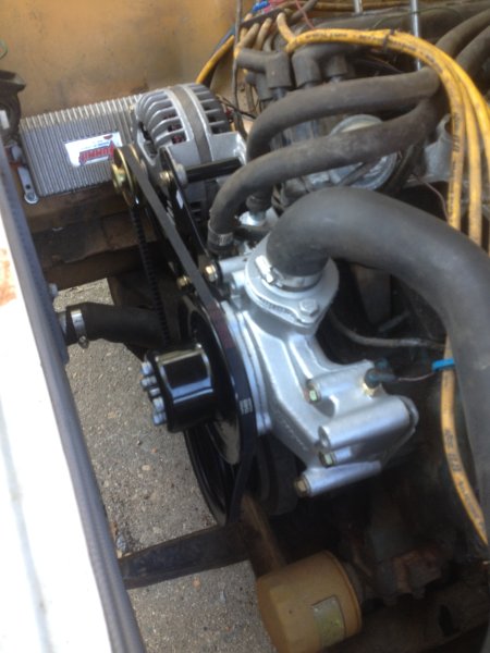

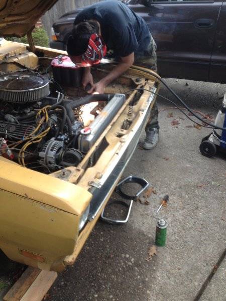

I used one on my 400 B- engine and an aluminum Summit radiator. It’s a close fit but it fits. You can see below how much room I had before I installed the fan. The pulley is on the WP and the aluminum radiator is installed.
I’m looking for the actual picture with the fan installed but I am having problems finding it in the sea of photos.

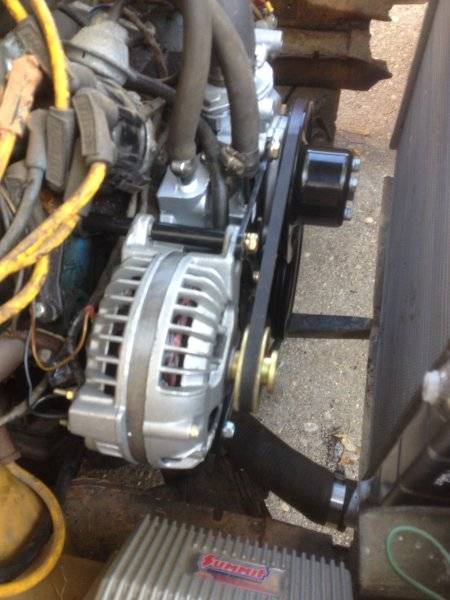

Thanks for the info, yes, I am going to get the hayden clutch #2947, and an 18 inch fan, btw, I installed a CVF racing serpentine system, water pump, and housing. I measured the pulley to radiator, and it measured four inches, the pulley snout is one inch, so I should be good to go.
That’s the one! An inch to spare as well. Perfect!
The pump snout will fit right inside and disappear.
