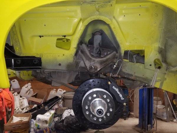

I used a Wilwood set from Jegs.
Cost was around $850 + $65 for a new set of Wilwood SS lines.
Conversion was fairly simple

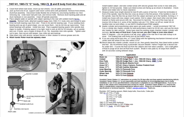

I also installed the Scarebird kit on my Charger last year. I tried to find some info on it, but it seems it may have gone out of production. It used to be "Product Code: BNE". Let us know what you hear from them. If they do still offer it, it's a good kit and fairly straight forward install with mostly off-the-shelf OEM parts (which is what i liked about it). The kit calls for rotors from a 70 Ford, calipers from a late model Dodge 1/2 ton truck, hoses from a Camaro, and a master cylinder from a '72 Cuda. Here's a quick rundown of prices:
-Scarebird Kit: $200 (after the tax and shipping)
-Rotors: $86 (Summit/$42.09 each)
Part#:BEN-PRT1016
-Calipers: $42 (Autozone/$20.99 each)
Part#: C554 (left)
Part#: C555 (right)
-Bearings: $25
-Master Cylinder: $26 (Autozone)
-Stainless Steel Russel Hoses: $42 (eBay)
The only thing left to buy are brake pads and you can spend anywhere from $20 for OEM replacements up to hundreds of dollars for extreme duty pads. So, realistically you're looking at around $500 after you factor in taxes, shipping, and a couple core costs if you don't have anything to turn in. Overall the kit was very easy to install and I'm happy with the performance too.
Edit: Here an idea of what's involved.
