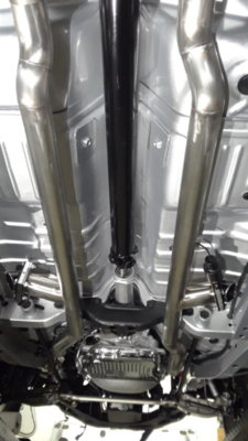

got it back from tim's shop got my 304 stainless exhaust, he did a great job on the welding and fabbing up the hangers. trying out the borla s-type muffler a step down from the loud as hell model attak series. about a weeks worth of work away from start up. so maybe a month, in full time job world, working on it whenever i find time,
Looks great! I have been toying with the idea of getting Borla exhaust.
