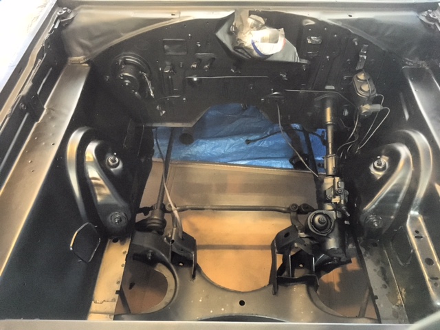

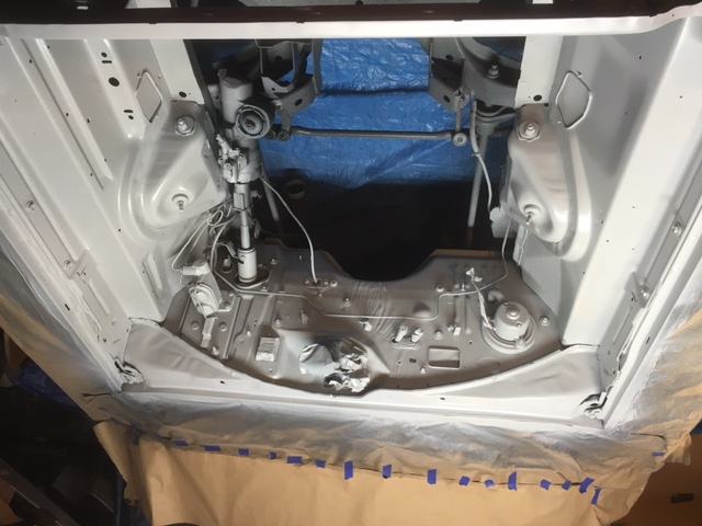

Sorry I've been busy lately and haven't gotten a chance to post pictures. We had a couple nice days the end of January in the 60-70's where I was able to spray the epoxy and 2k high build. I do have a question though. I don't have as much plum crazy purple left over as I thought I did (half a pint) Should I buy a quart and be done with it or buy a gallon so when I do the exterior in the future (next year at the soonest) its the same mix/batch? I'm worried about it blending/matching but I understand there is a lot of variables that will play a part in it matching such as humidity and air pressure. So I'm not sure it will make much of a difference as it may or may not match regardless..?

Thanks guys, it came out pretty good so far with minimal trash in the paint I think there was even a bug or two...In January...lol. I wound up spraying epoxy around 11am then added the filler that night. The next day I did some more sanding had a couple spots that were funny. If you notice in the picture with the black epoxy under where the battery tray would go there must have been oil or something... I'm not sure if I didn't clean it well enough with wax & grease remover but I wiped it real good sanded it and wiped it again. Then on the 3rd day I sprayed epoxy again to seal in the filler, followed by about 3-4 coats of 2k high build. I sprayed the K frame a Jet black gloss.
