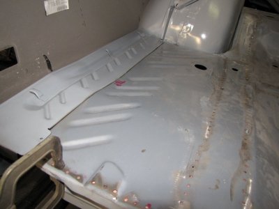

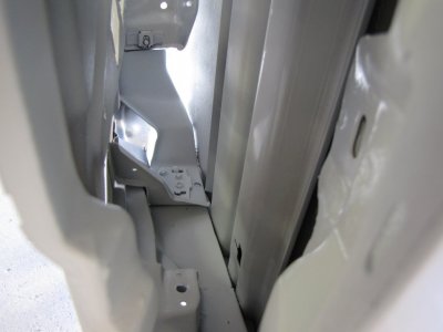

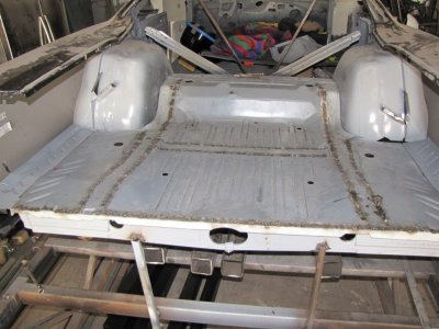

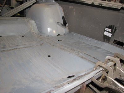

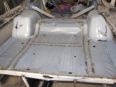

Trunk Floor and Qtr drop offs installed! The head of the Drop Offs (where they meet the Wheelhouses) had to be chopped about 2 inches as I did the tubbing all the way to the Frame rails and the wheelhouses are bigger now. I used to be frightened about cutting this or that, not any longer! Cut it and re-weld it! Pics coming tomorrow.

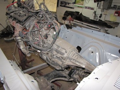

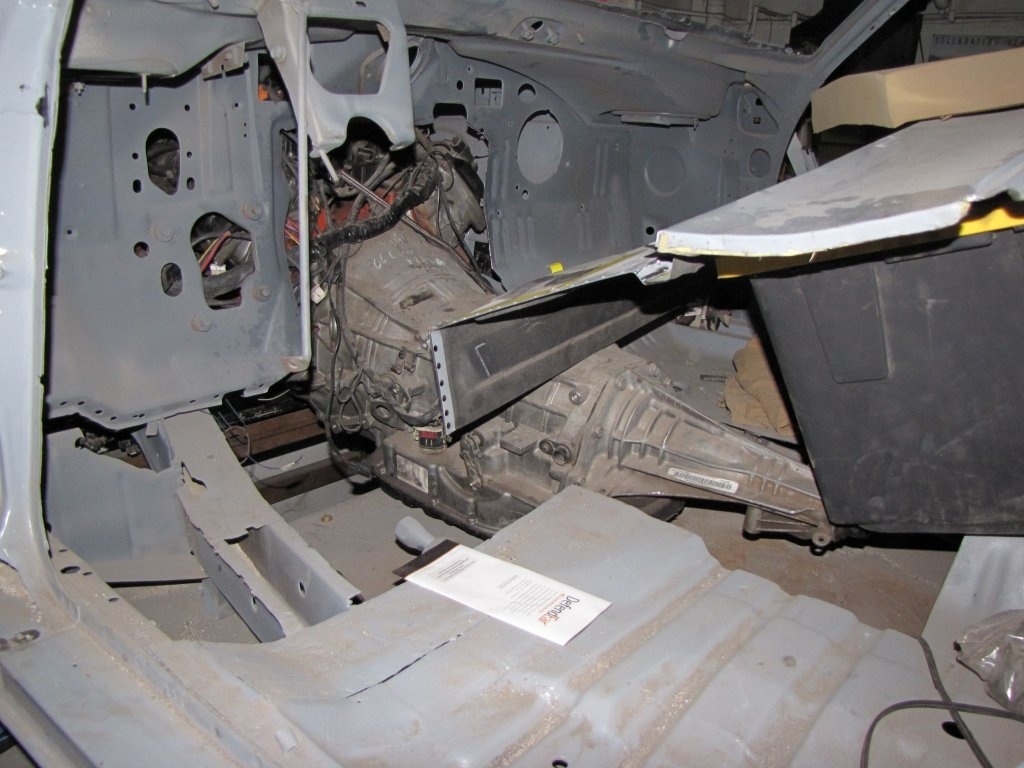

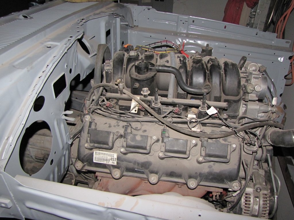

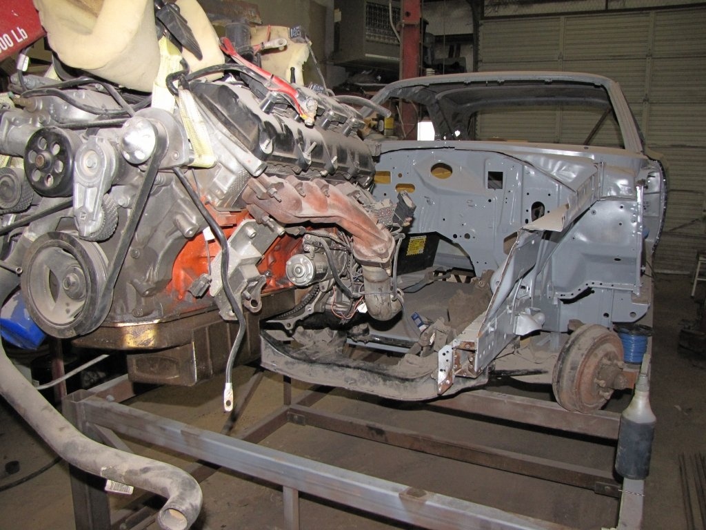

Ok ya'll, greetings! Since getting bitten by that German car thing; ie the Porsche 928 I've found a new love and went out and bought a second 928! So, something had to go...and it was NOT the Satellite, it was the GTX. So...I've been super dooper busy on tons of paying project cars. Insanely busy! I certainly need some help, but as everyone knows, it's hard to locate and keep good help due to many issues. So, all we can do is plug along. Here's a cool shot, underside the Satellite with the 5.7 in it. As soon as I get ride of James' Challenger (almost done), a 69 Camaro and the little fella GTV Alfa Romeo, walls come down and floor space increasing and a dedicated space for my Satellite operations!
