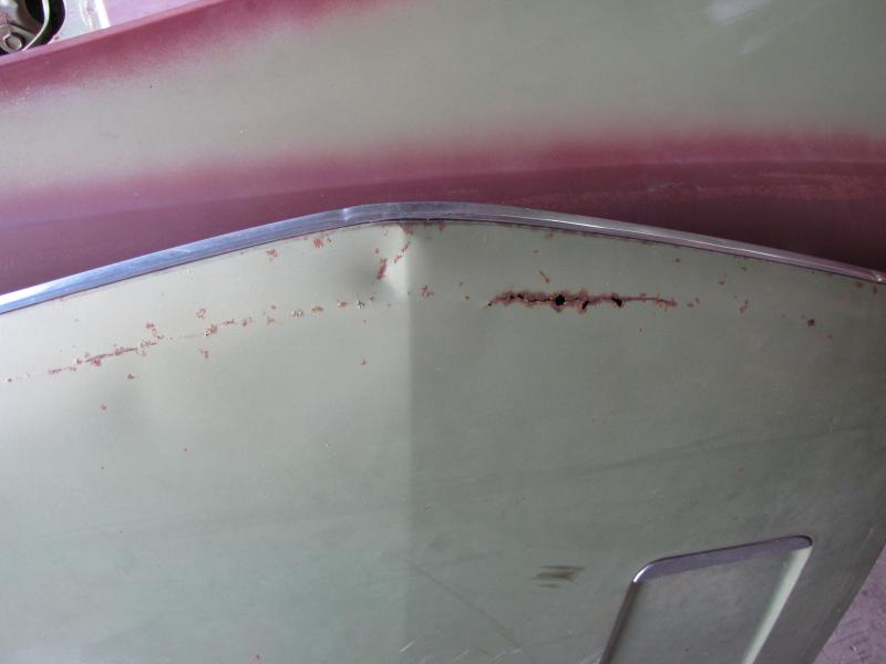

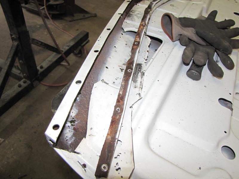

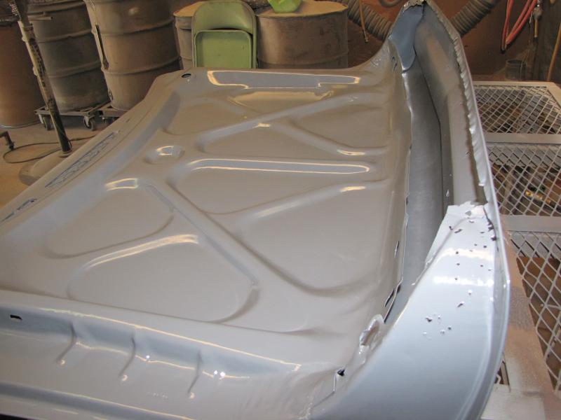

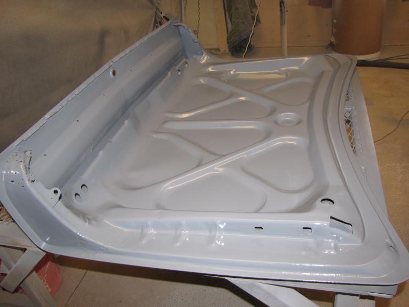

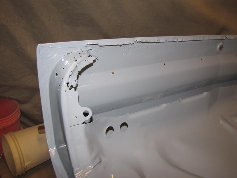

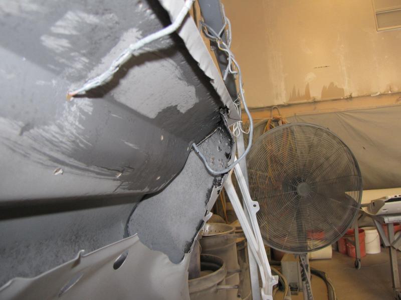

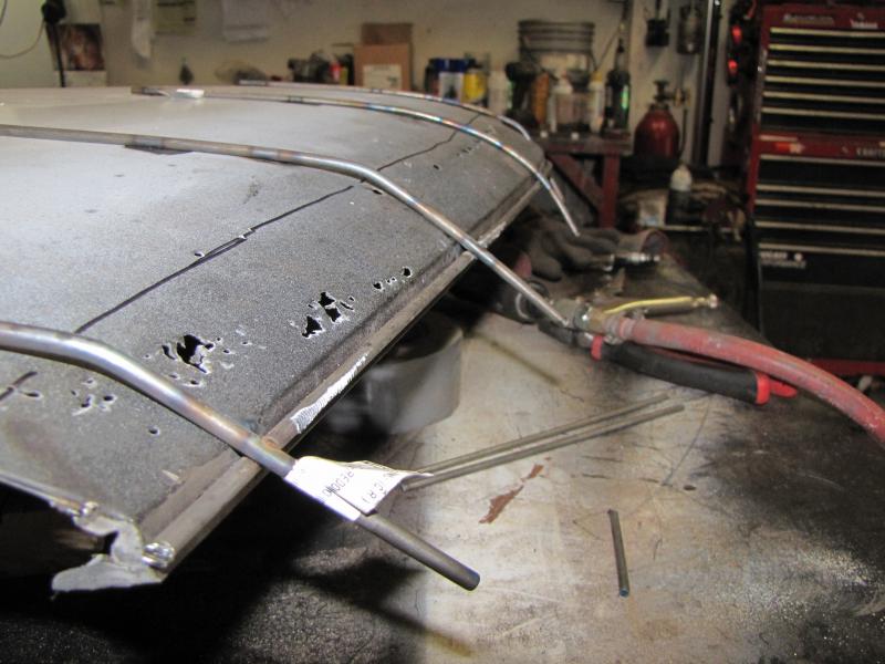

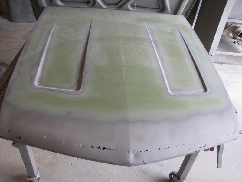

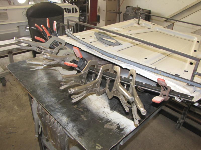

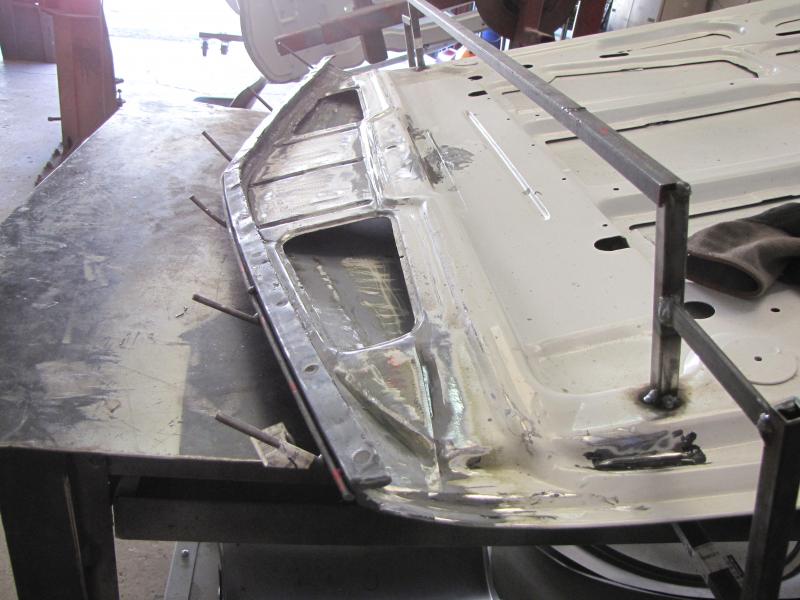

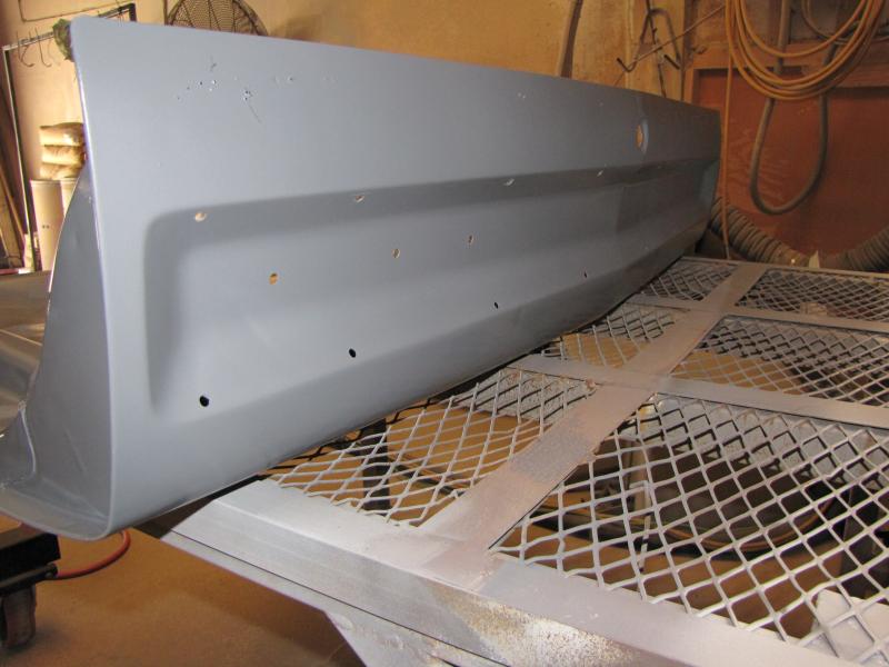

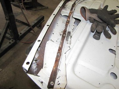

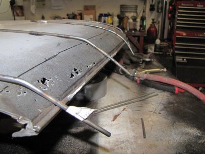

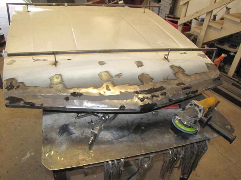

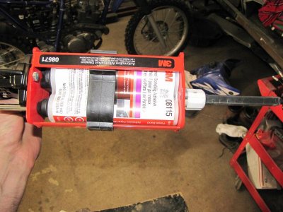

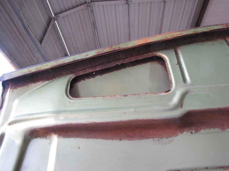

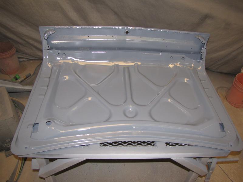

What got me started down the road using 3M Panel Bond #8115 was I asked around the old timers at Jack's Paint Place across the street from me as I go over there and shake up qts and gallons of Epoxy when I need 'em shaked. I asked about this glue stuff they were using to put panels back on, he showed me, I asked if it can be machined; ie sanded. It can! At this point I knew how to repair the Javelin Hood I was doing late last year. The Javelin Hood is just not easy to acquire. The entire nose was rotted like swiss cheese, so, I cut off the inside webbing (like I did here on the Satellite deck Lid) blasted the inside as best as I could, Ospho'd it, epoxied it, and repaired the back swiss cheese sections with Panel Bond and replacement sections (metal coupons) glued to back sections of the webbing. When that was repaired and the glue oozed through the swiss cheese holes I sanded it down, reshot epoxy, and glued it to the main Hood. Panel Bond is about 50 bucks for a two part tube. Each special mixing nozzle is about 3 bucks, and is tossed after use, the applicator gun is about 75 bucks, but, all well worth it as I usually end up buying tools I use at least 2 times. Anyways, here's some pics of the Javelin Hood repaired with the 3M product. It's an AMC car, so, technically it can fall in the MOPAR family! lol
