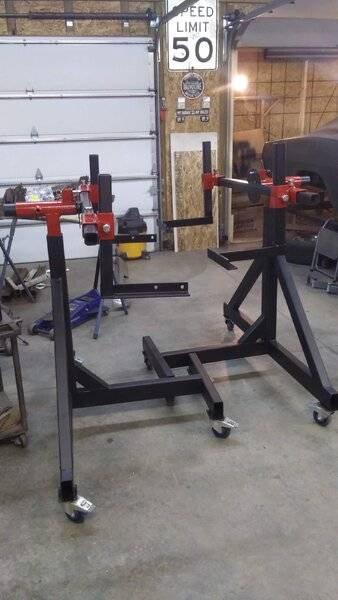

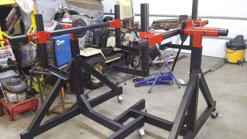

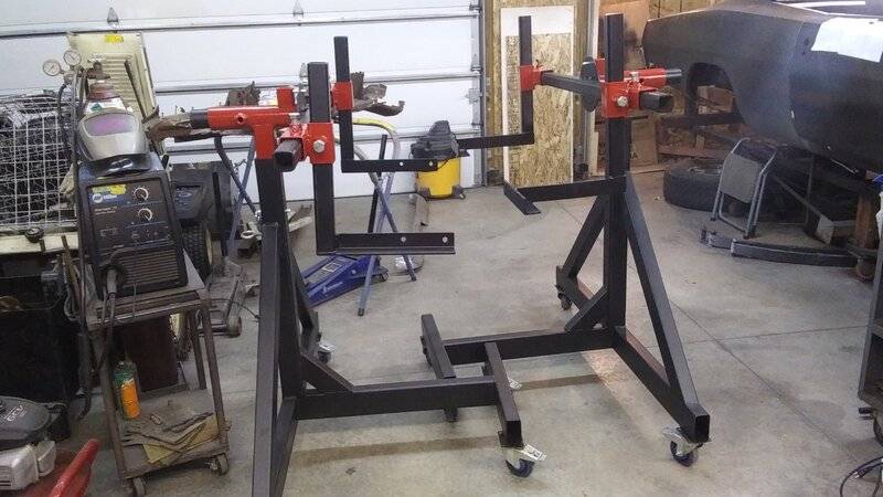

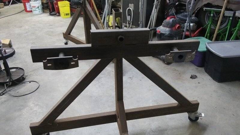

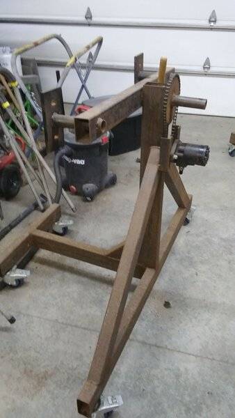

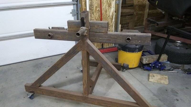

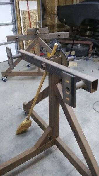

Since my project is getting close to being ready to mount onto a rotisserie, I needed to get the ones I picked up 5+ years ago ready.
I started with these which were a bit hoaky and definatly NOT going to work!
And modified them into this....
652[/ATTACH][/QUOTE]
Need to ask how much in labor and materials did it cost to put them together.
Blocked mine up about 12 inches and wish I had bought a rotisserie would have made the job so much easier. But toughed it out and got it done. LOL. Good job on the modify work. :thumbsup:

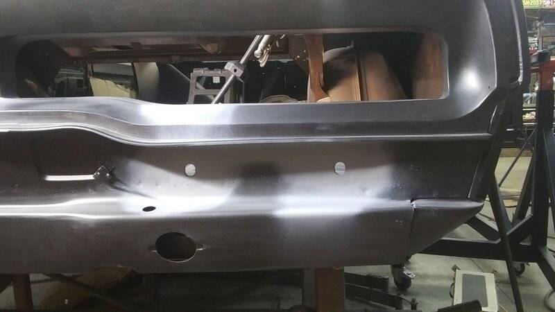

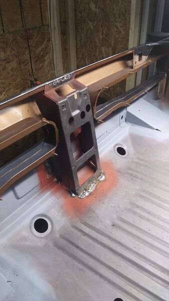

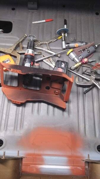

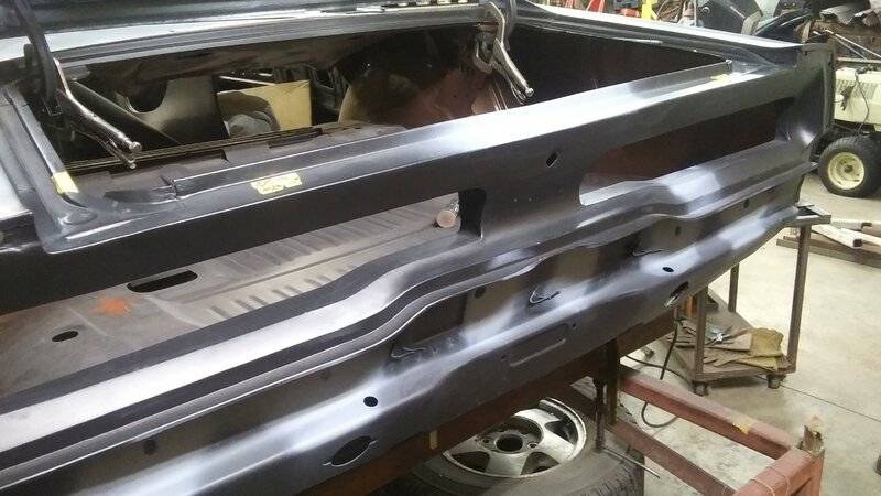

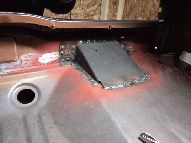

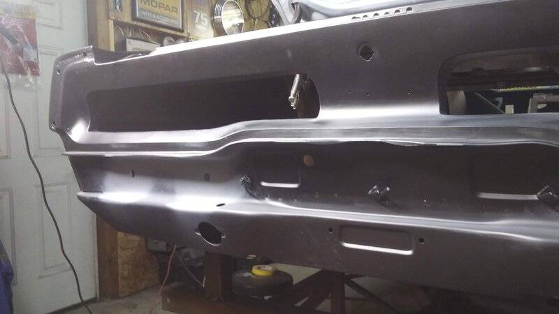

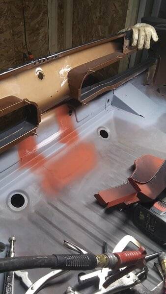

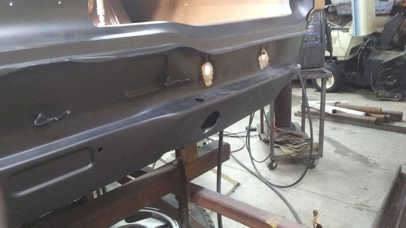

So next on the list is getting the bumper brackets welded into the trunk.

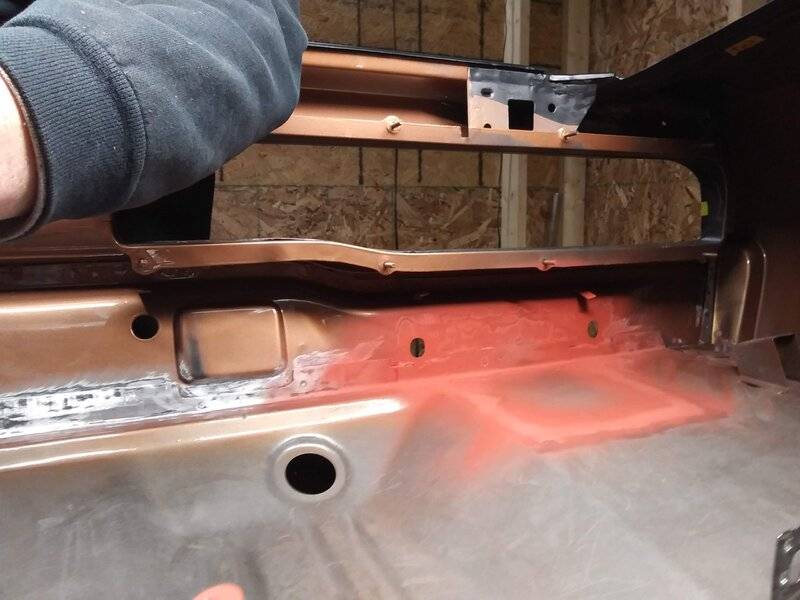

prepped the area and sprayed the weld through primer.

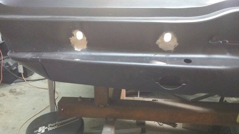

view from outside
and now there in

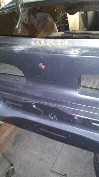

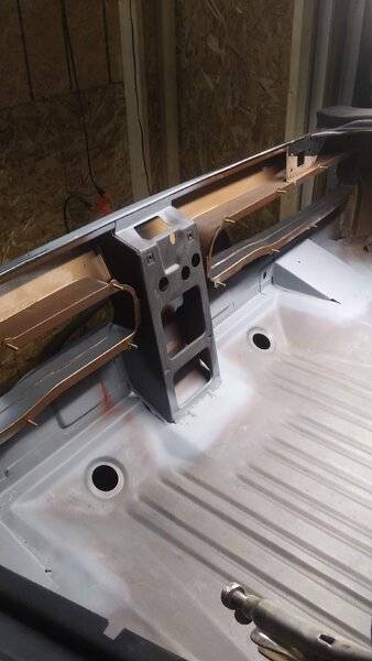

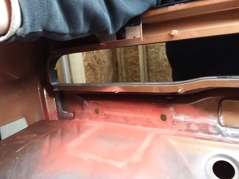

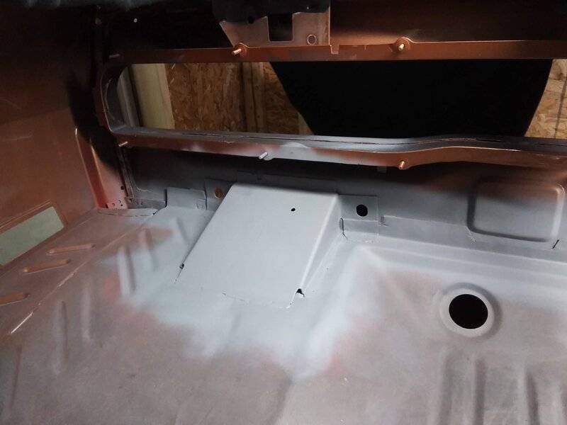

So before these were welded in I seam sealed behind the brackets (white smudges) Kinda hard to do after there welded in!
And some pics after cleaned up and primed
and cleaned up from the outside

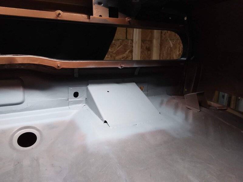

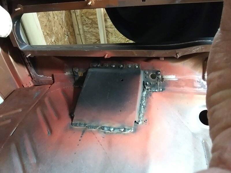

Might as well get the trunk lock support bracket in.... (*note the white smudges in the 1st two pics)

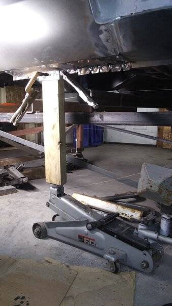

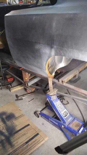

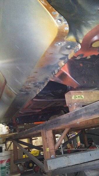

The next area to weld was along the bottom of the quarter panel to the rocker.

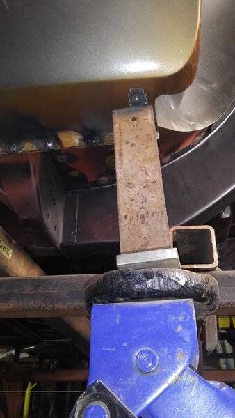

This is how I made sure the metal was pinched together before welding.
I used this method (using the jack) to make sure the metal was pinched together along the pinch weld.
Sorry this is the only pic I have

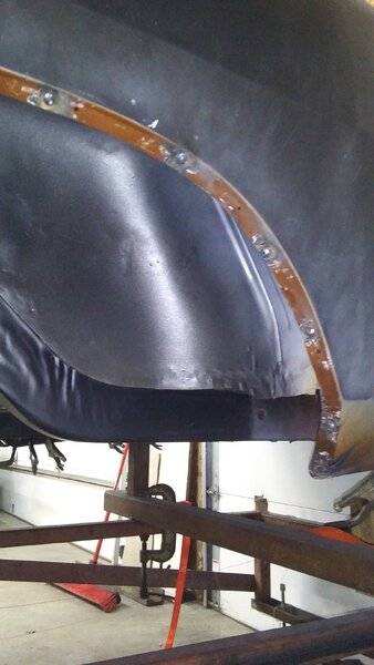

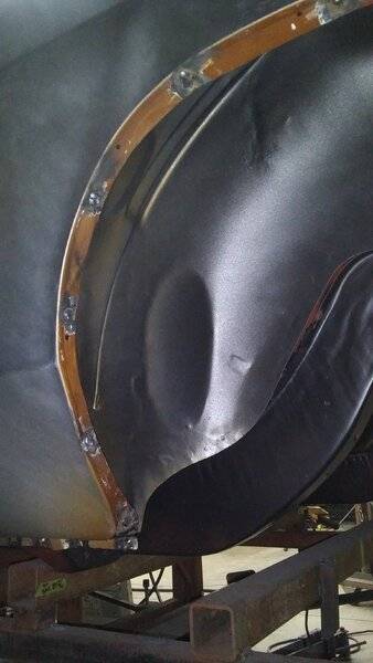

Welded the wheel arch.
I will come back later and double the welds here. These are about every 5 inches
I did the same thing to the passenger side, this pic shows jacking up with the block right against the pinch weld
Sorry another bad pic
If you notice the quarter at the pinch weld is a little long. I will go back and trim this later.
