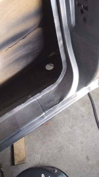

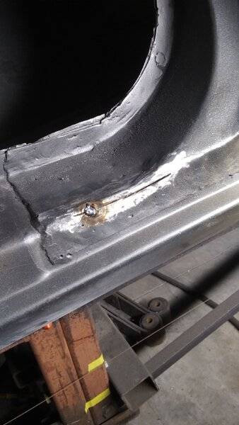

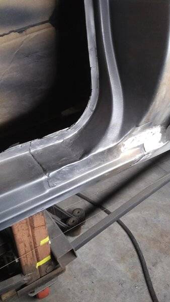

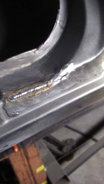

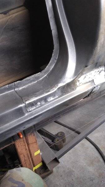

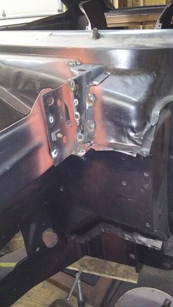

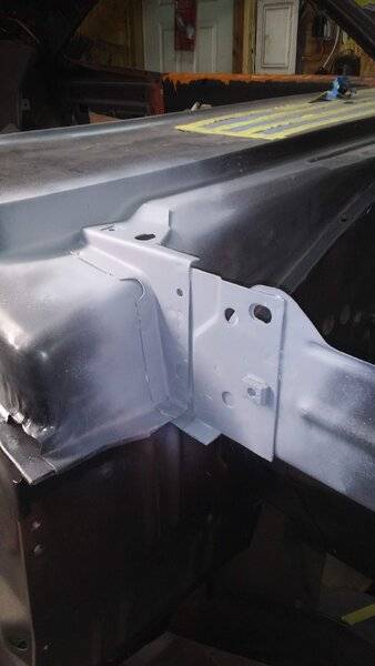

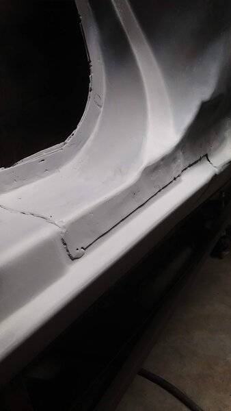

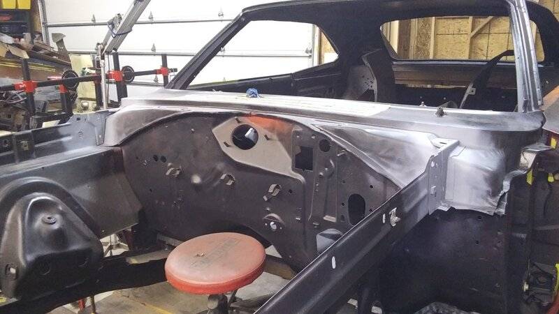

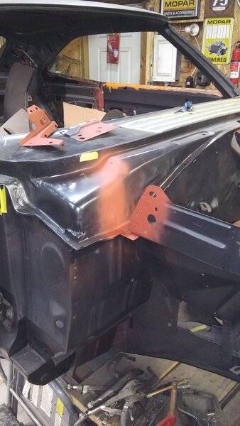

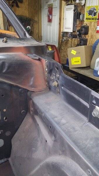

I didn't like the looks of the lock pillar down where it transitions into the rocker.
The outer edge was a bit banged up and to sharp
So I made a slice and hammered it down softening that edge
then welded it and finished it off
When I get to the body work stage I will come back and fix the edges

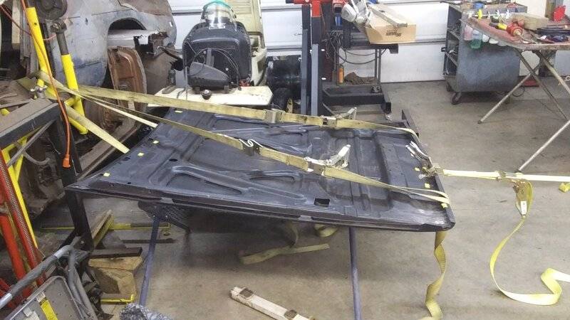

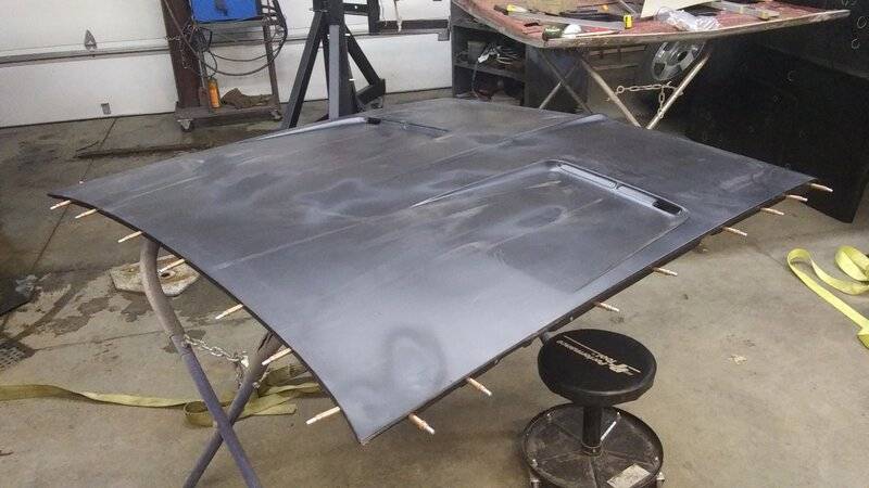

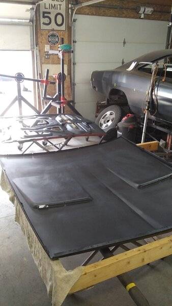

So I decided to take a brake from the quarter extensions and fix my hood. It had been hit in the front and someone attempted to fix it but needed more attention.
I tried pulling it out...... but that was a wast of time!

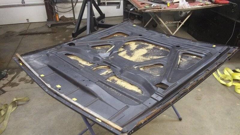

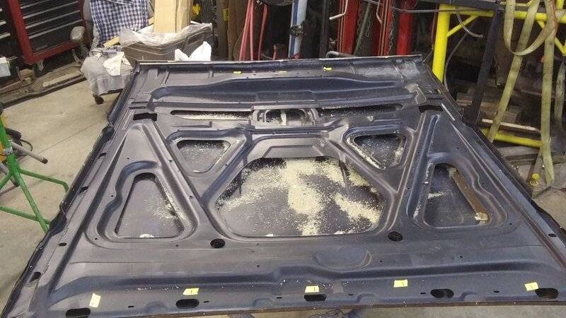

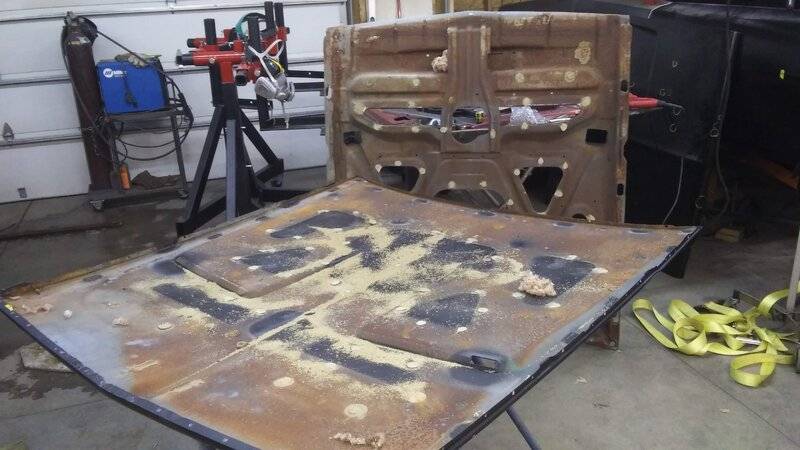

So because the damage was along the leading edge where it is double walled, I decided to separate the inner from the outer skin.
1st I drilled 1/8 holes and added the clecos. I wanted to be absolutely sure that everything would be aligned when it went back together.

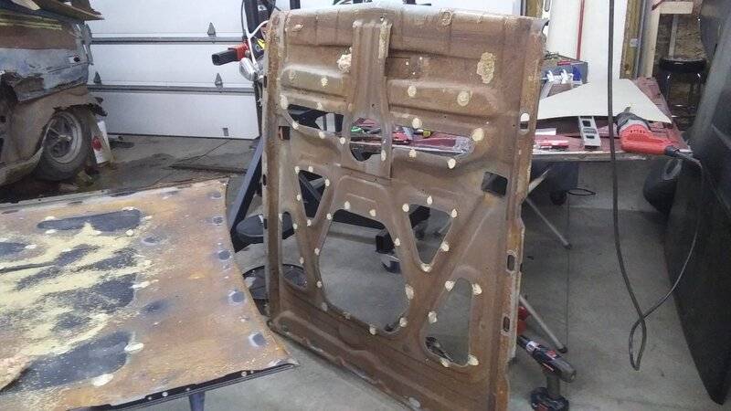

After drilling out the spotwelds around the perimeter, I used a long sawsall blade and cut the old seam sealer in-between the two halfs
Then it came apart
Did you see the mouse nest?

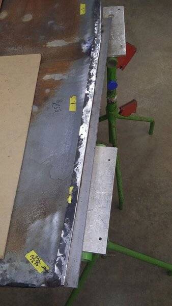

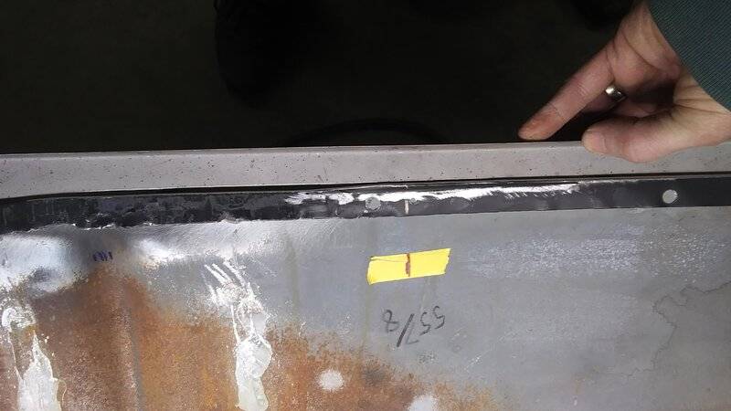

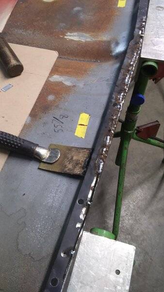

I made a profile template from another hood I have and used it to check the front edge.
I slit the fold and pushed the contoured edge until it matched the template then tacked it. Kept working the edge until it matched my template then welded it up and ground it down
Grate job. You saved that one. The mouse had a home there. Lot of work but probably cheaper than buying a new hood.
Wow amazing work Don!
Thank you
WAY CHEAPER just takes time!
Now you know why my build has been like 9 years! :rolleyes:
Very brave Don. I don't think I would have taken a hood apart. Looks good! Nice job
When I looked at the cost of a new one.... just under a ONE THOUSAND DOLLARS (ouch:eek:)
I figure, how bad can it be? Like I said above it's WAY CHEAPER just takes time!

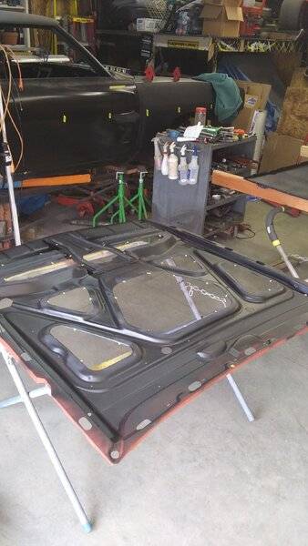

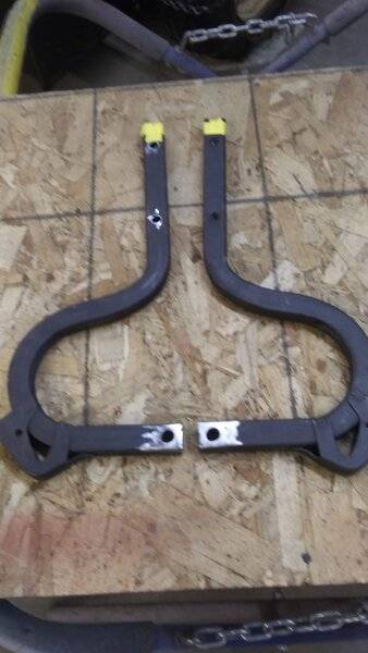

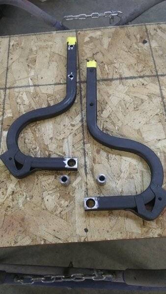

I wasn't happy with the sloppiness of my trunk hinges so I made some bushings and welded them in.

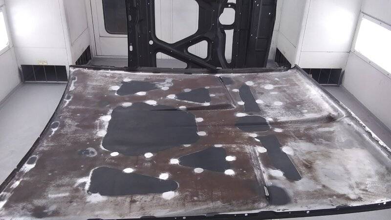

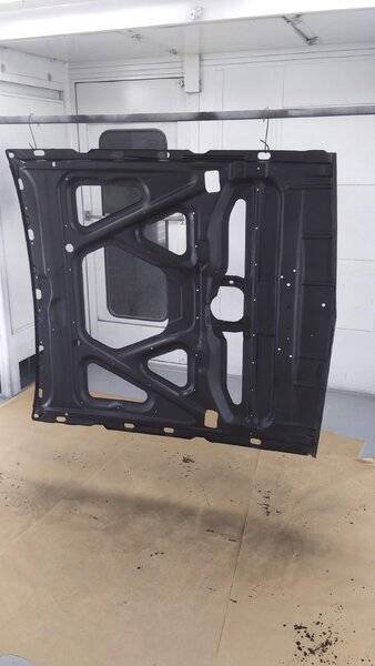

I epoxy sprayed the inner structure

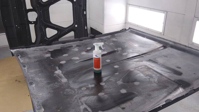

then prepped the outer skin with Auto Tech Rust Prep.
This is the same stuff I used when I did the roof.
Before
After

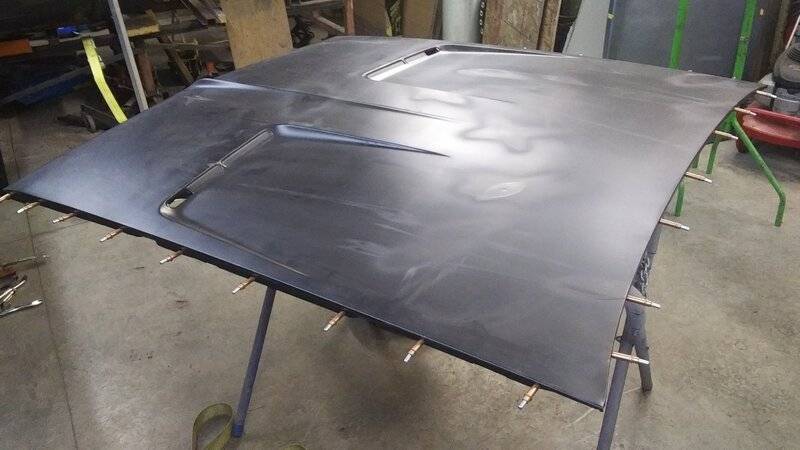

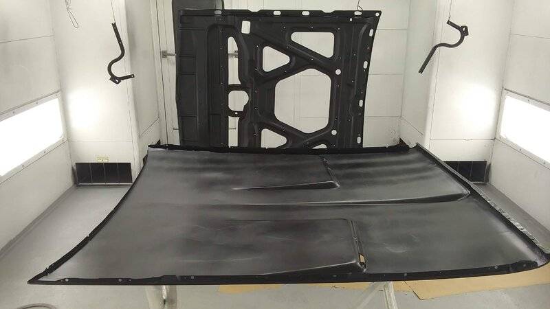

Then I epoxy sprayed the outer hood skin and trunk hinges

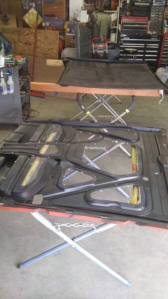

Before assembling the inner and outer pieces I made a cradle to support the outer skin.
prepped them with weld through primer
I used 3M NVH Dampening Material 04274 as the bonding material between the inner and outer.
(1 tube was enough) Unfortunately I did not get any pics! Or of the 2 half's together. Sorry
But I can say it went together very well.
I aligned the holes with my clecos and welded the 2 half's back together.
This is the only pic I have of the hood with my toothless grandson
