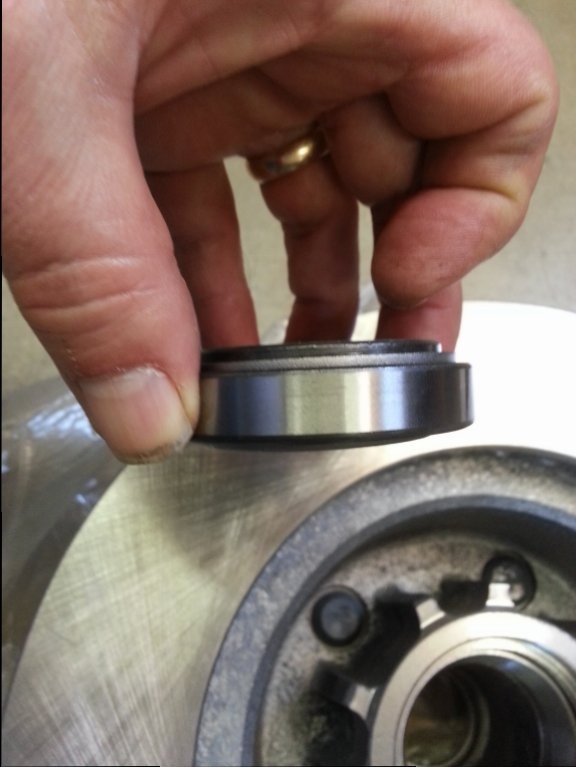

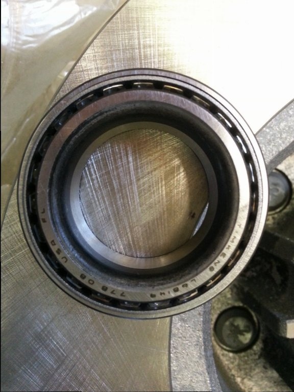

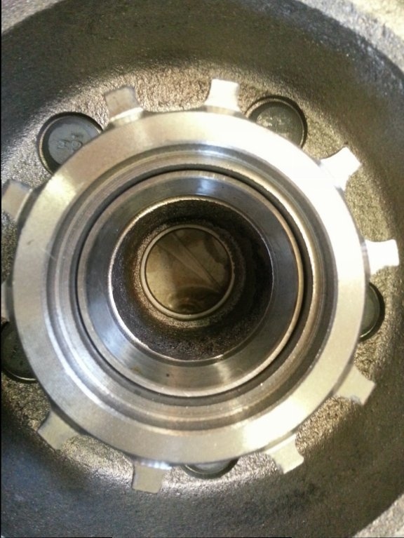

Is it just me, or does this bearing look correct? The rotor's race is beveled steep, the inner wheel bearing has no bevel?

Does not look right to me. Both inner and outer bearing should have a bevel to both. Only difference is one bearing is different diameter. Cass might have sent you the wrong one, IDK. But, you should be able to get one from your local parts store if need be. Timken bearings are only a few bucks

I'd take the rotor to a parts store. Tell them to pull up a rotor bearing for a 73-76 A body, like Duster, Scamp, etc. See if the bearing(s) you need fits. Hopefully, you don't get a punk kid who looks at you like you have a third eye when you say "Plymouth".

Super fast response from Dr Diff:
The bearings look correct. I prefer to replace the races that come installed in the rotors with the extra Timken units, but it is not mandatory. If you decide to replace the races, you must drive them out with a hammer and punch.
