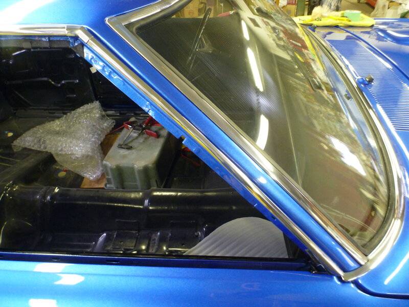

1969 RR 383. When I install the drip rails do I need a small amount of RTV on the car before installing? What's a good way to install without ruining or bending?

I assume you are talking about trim installation, so I would do it dry and carefully/slowly by hand with the assistance of a rubber mallet if necessary. If you need it, some soapy water for lubricant.

Thanks, yes I'm talking about the trim. So no RTV, I always thought you had to seal it.

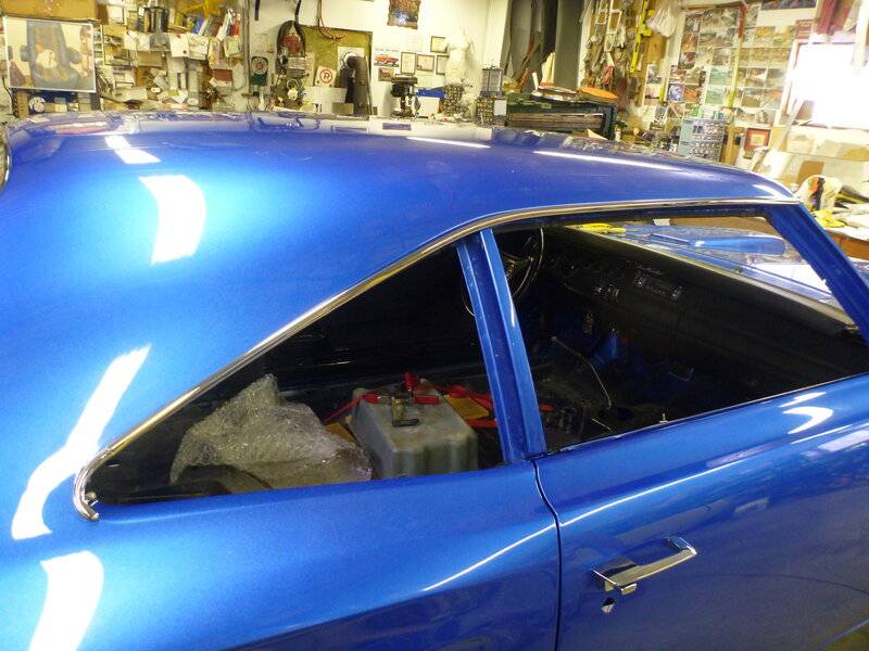

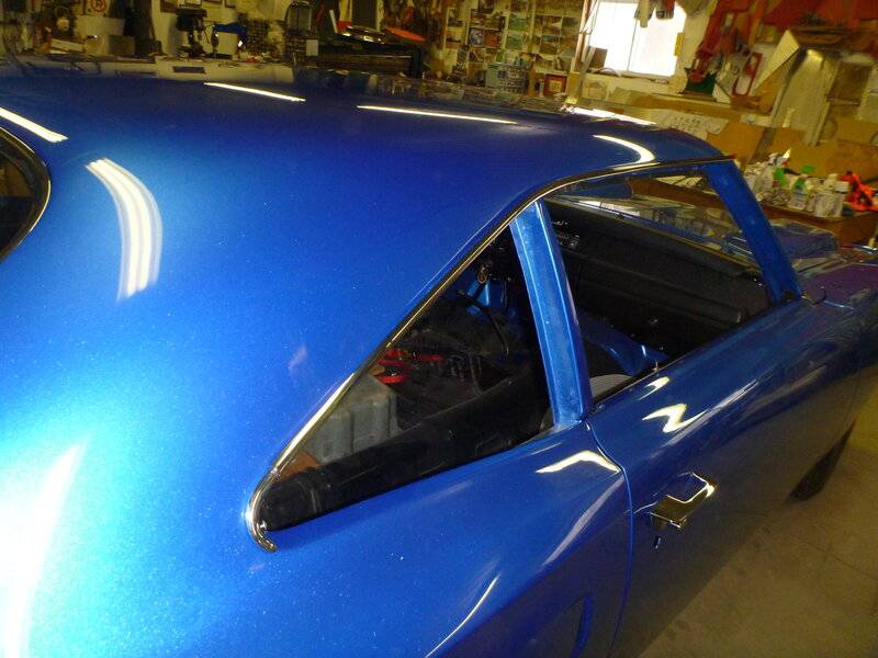

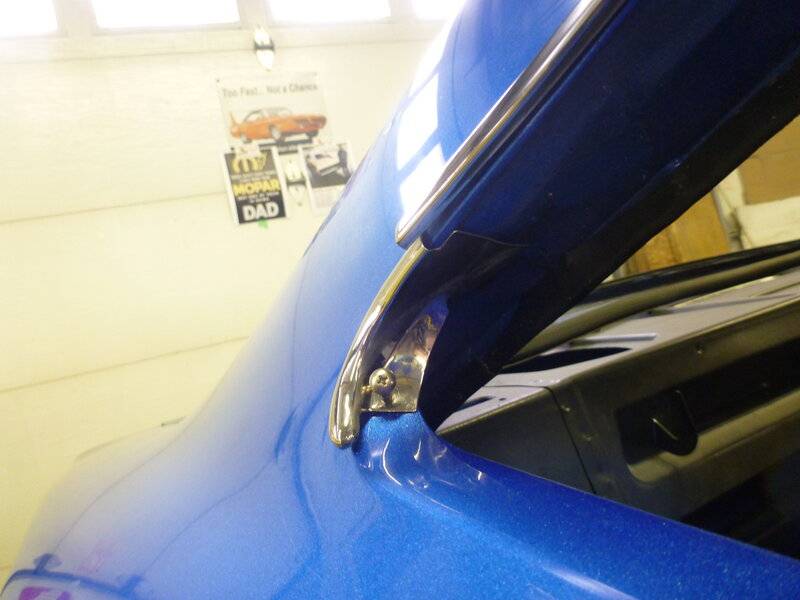

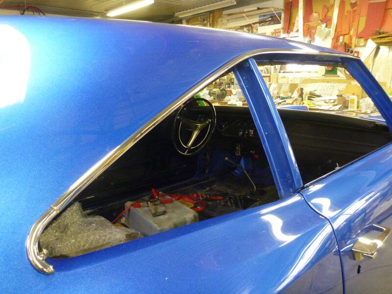

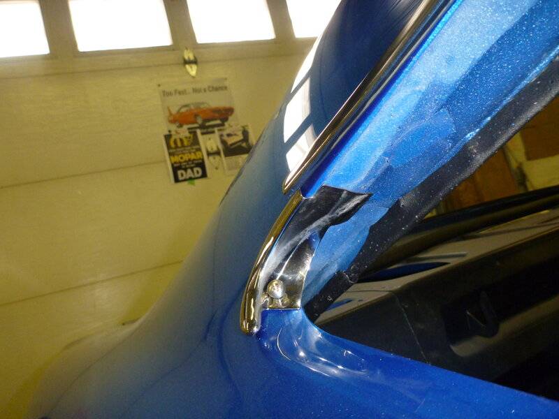

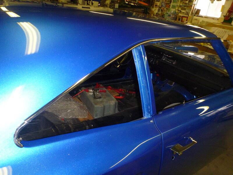

They should pretty much just snap right into place by running your hand down them. Start at one end and work along..
