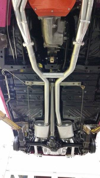

Looking to see what you guys are running for driveshaft loops. BTW I'm running full 3" exhaust.

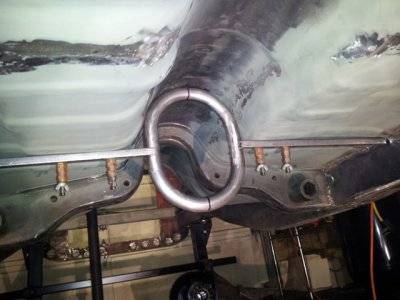

I just have one of these
that is the one I have on my car with 3 inch exhaust and cut outs

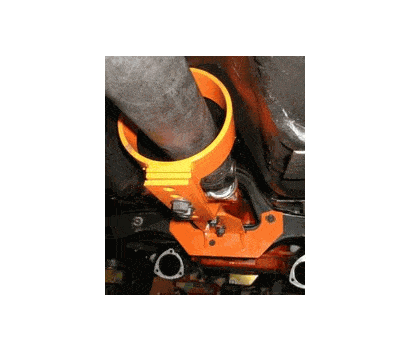

Mancini Racing makes a nice bolt on loop. Bolts to the cross member so no holes in the floor. $180. POPS
DVW looks tight between the driveshaft & exhaust. How much clearance do you have? I'm thinking of either a carbon fiber or aluminum drive shaft. The carbon fiber needs to kept away from heat of 200 or higher if I remember correctly.

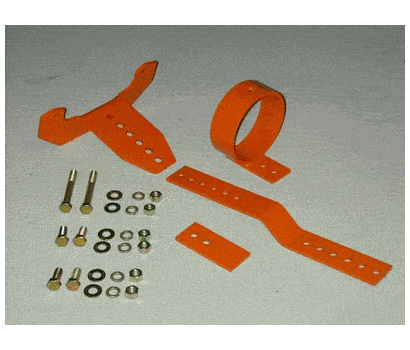

I have something like this just in T6 either 6061 or 7075 Alum
I can't remember which alloy
{IIRC it was from Pro Aluminum Products, not sure they're still making them,
I purchased a couple of them 10+ years ago, I'll get a couple photos of it & post it a bit later

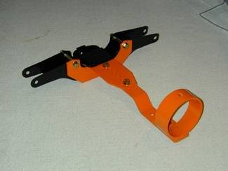

this is one from Mancini Racing below Like $179 {steel} IIRC
not cheap but a bolt on
not my car
another look at the parts
MRE Drive Shaft Saftey Loop Steel bolt in-trans crossmember MRE-18055 $179.95.gif

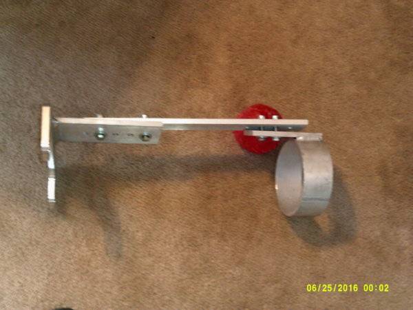

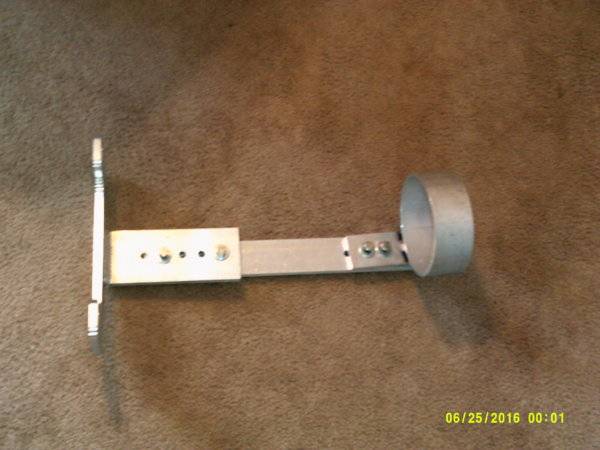

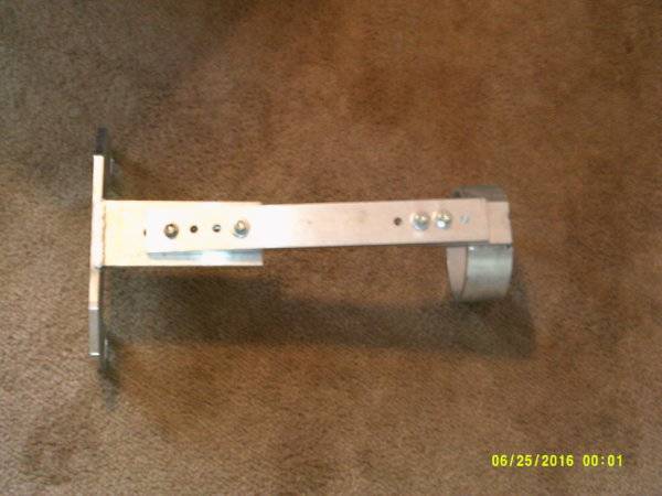

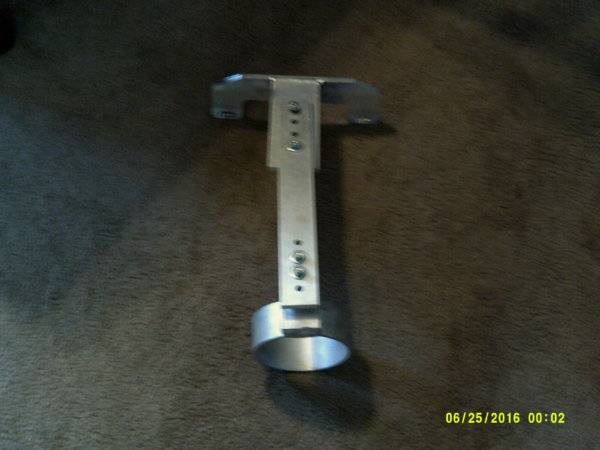

Here's the aluminum one from IIRC Pro-Aluminum Products I have
it was $100 ea. or so IIRC, a decade ago
other than being Alum not steel like the one above the
bar between the cross-member attachment section & the circular loop
is straight, the one above {steel version MRE} has a
slight step bend in that piece

I fabricated mine and welded it into the floor of my 67 Belvedere convertible . . .
My car will be a street car . . . but I wanted to add it into the car now while I was welding up the metal . . .

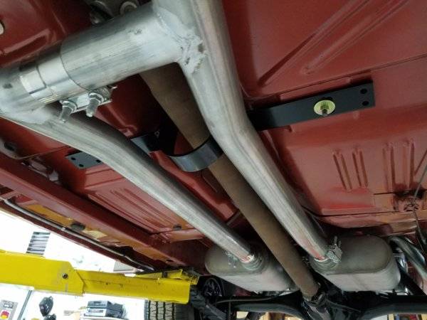

I bought the cheap $20. kit from Jegs. Modified it with welds instead of the bolts, and anchored it to the seat studs.
not my car
Those are made by US Car Tool. I've used a couple of them. Real nice setup.
