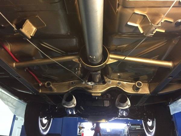

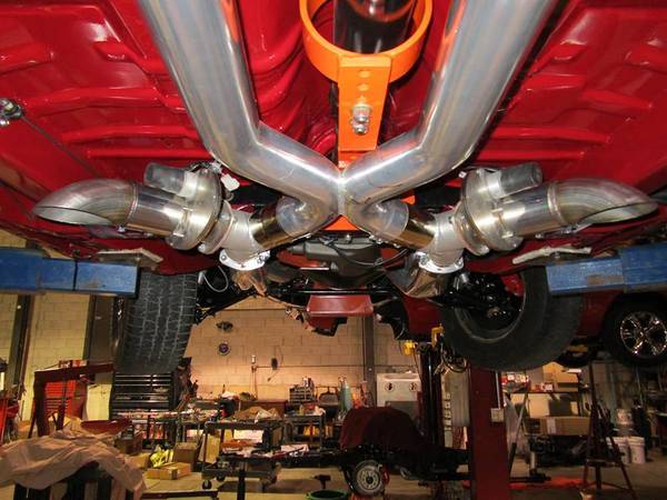

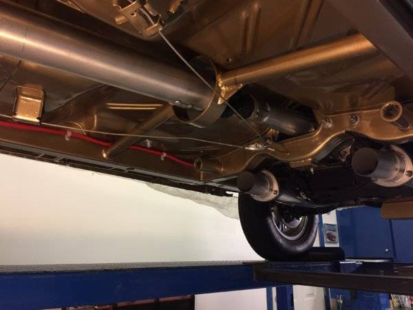

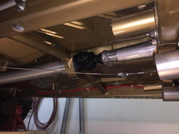

DVW looks tight between the driveshaft & exhaust. How much clearance do you have? I'm thinking of either a carbon fiber or aluminum drive shaft. The carbon fiber needs to kept away from heat of 200 or higher if I remember correctly.
It has at least 3/4". The nice thing about welding it is that our can tip the loop what ever angle you need. I cut the 90 degree ends off from the floor mounts. Save these cutoffs. Then tack weld bolts into the holes. Drop these parts in from above the floor under the carpet with the bolts sticking down through. That way the loop can come off easily without having to lift the carpet. As for aluminum shafts. My 9.0 raccar has 500 passes on one, no issue. You'll find steel shafts aren't even legal in Pro-Mod. What does that tell you?

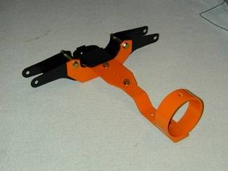

US Car Tool Has this one for $159. looks to be same as Mancini Racing but $30. Cheaper
http://store.uscartool.com/bolt-in-driveshaft-loop-mopar-a-body.html

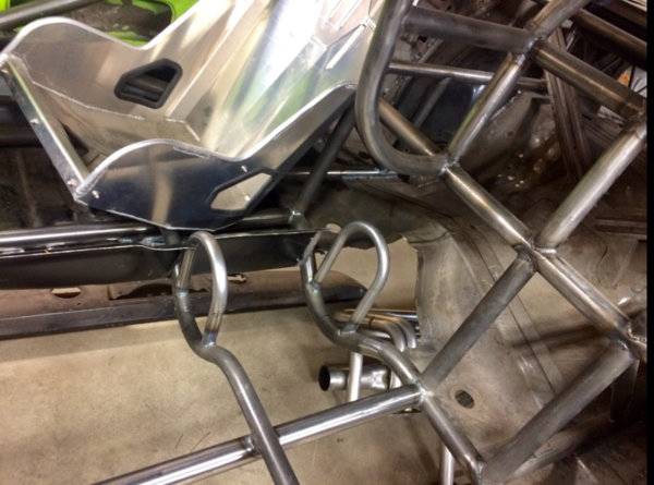

We incorporated mine with one of the undercar bars for the 25.5 cert. The NHRA official says it is a grey area because it does not say in the rules that this bar has to be one solid bar from side to side so we make them removeable to ease getting the transmissions in & out & incorporate the driveshaft loops in this bar as well. He says it's grey area but it passes.

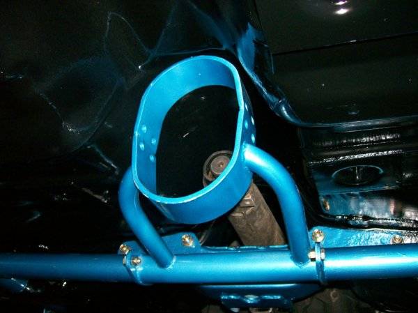

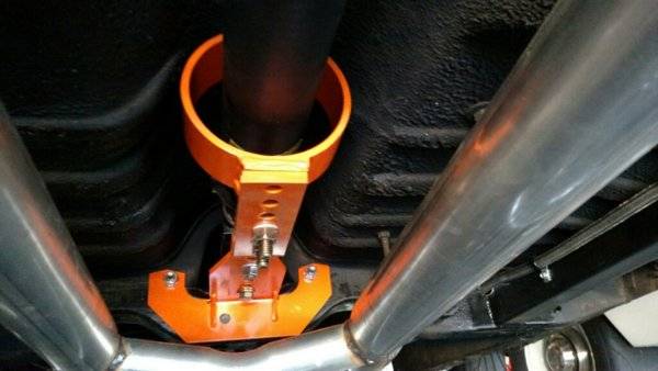

This is my updated hoop. It's actually a few lbs lighter than the previous 1/4 X 2" flat bar design that used to bolt to the back of the crossmember and the floor. Torsion bars easily get by when removing.

Malex that's one Badass Hoop you got there, Thinking i'm going to be copying it !!
Cool! You know, when I put it into place I though that it would be tough, but it was the opposite. I simply put it upside down, slid one side in the one hole first and then the other. Then I just give it a 180 degree spin up into place, welded it up.
