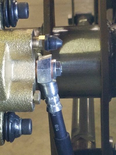

As a reference, my lines and hoses
are 1/8" I'd, MC bore is 1.031, dual
diaphram booster, 2lb residual check
valve in both line circuits.

The entire line need not be replaced.
You're going to have hoses to the
calipers. Allow 2-1/2" to 3" travel.

99% of newer vehicles have floating calipers. Hence the need for a flexible hose.
If you use a fixed caliper with pistons on each side then they could be straight steel line.
