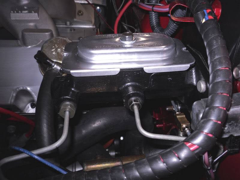

Here is the one I run with. It gives me a good firm peddle and the brakes seem to pull straight. Actual stopping ability still sucks though, with the drum brakes and a motor that idles at 1500 rpm.... :)
Thats great help ,thanks alot ,that is the same master cylinder i have on my bench .I still have the poly in it so i dont go fast ,so it stops okay for me
