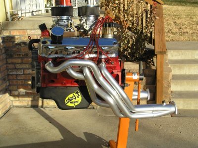

I use the Dupli-color myself. I have been very pleased with the results. I use it on about everything auto related. I don't give a squat about 'original' anything. A real car back in the day would've been modified somehow about the time it came home :-) Be imaginative. Make it what you like.
