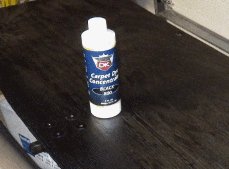

I did my sun-bleached Barracuda deck carpet a while back with this DK product. I didn't want to use the spray paint dye.
It did OK IMO. Not as dark as I would have liked but it didn't make the carpet stiff. Not sure if they have dye for other automotive items.

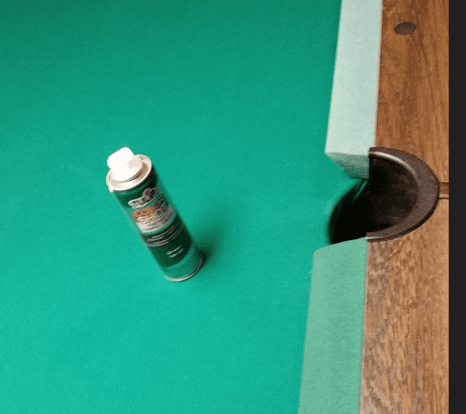

FWIW, before doing the car carpet, I tried some rattle can spray dye from the local craft store on felt covered pool table bumpers. Had to brush them afterward to soften the felt. I'll likely not do that again.

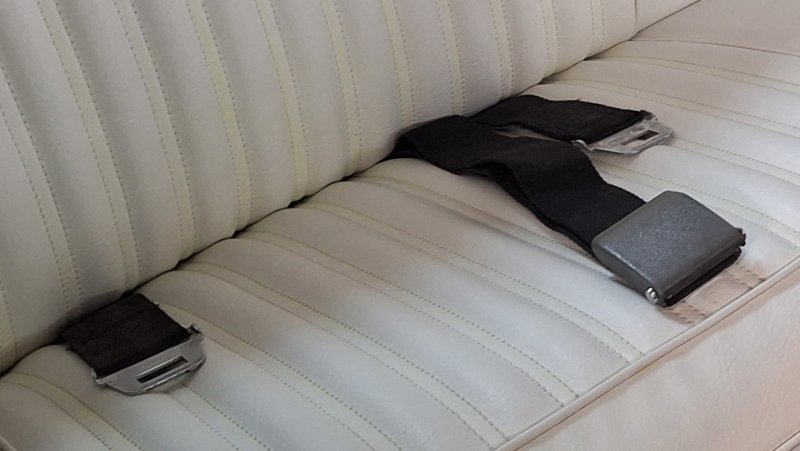

I dyed mine a few weeks ago from red to black. They turned out great. I used RIT and followed the instructions for nylon. This calls for hot water 140f or higher. I used a hot plate and a propane torch to heat it up quicker. The recipe also calls for 1 teaspoon of dawn and 1 cup of white vinegar. Wash after with water and then wash again with water and dawn. Drip dry. The dye will not harm the chrome but will affect the tags and releases if painted a non black color.
Yes, I dyed a variety of colored belts to black using RIT dye. The dye doesn't stick to the metal. Do the dying outside on a camp stove as the black vapor can do a number in your kitchen!
Be careful, if the black dye transfers to the white vinyl it will be impossible to get out…
