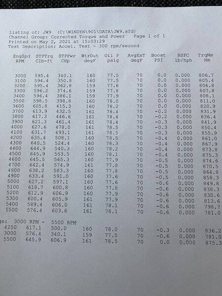

Hey guys! I just finished my 440/500 build and ran it on the dyno.. But i was a bit dissapointed, it stopped making power to early, sure got some nice tq numbers but the rpm are to low, i was hoping it to be happy for atleast 1000rpm more, but it died off. So i need your experts to give me some clues of what could be wrong with my build.. Here are my specs to start with...
.055 over 440 with 440source 4,15 stroker kit
11.6 CR
Untouched TF 240 heads
Brawler race 950 cfm 4150 carb
TF Trackheat intake
Crane ductile iron 1.6 rockers
PAC 1.46" springs. 120lbs seatpressure @1.9" Installheight, 394lbs Open
Howards Solid flat-tappet .657/.661 (with 1.6) 260/264 @.050, LSA 108, ICA 104
MSD Probillet dissy 32degrees full ignition.. Tried 36 but made more power with less
And here are my dyno sheets

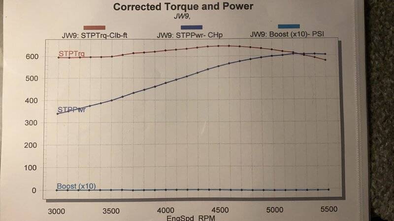

That looks pretty close to what the 446 cu in dyno mule made just at a lower rpm. My guess is bigger ports and bigger roller cam to extend the Rpm with a 500.

I think it’s a bit optimistic to be looking for the motor to peak at 1000rpm higher than where you’re at now.
Std port windows and 500” don’t usually peak really high.
The springs on the heads are def a little light for the cam/rocker combo, so I wouldn’t be surprised to see the peak get shifted a little higher with the new springs...... maybe closer to 6K.
The tq is good, and at a sufficiently high rpm, that if it can hang on a little stronger after peak....... you’ll see that peak hp happen a little higher up.
It would have been nice if there was an air turbine being used...... then you could monitor the air flow going into the motor.
When the springs start losing control, it shows up in the air flow readings.
I’m wondering why there are no bsfc numbers...... running efi perhaps(and bypassing the dyno fuel system)?
Did you make any pulls to a higher rpm to see what happened with the curve?

Recomended springs are 142 seat and 420 open. Mine are 120 and 394 (trickflow rated them for .700 lift according to their catalog, thats why i didn't change them, but their specs are wrong!).. According to the tuner and a engine builder here they pull mopar strokers (500,505 and 512) higher and same power numbers on untouched chinese heads.... And i trust those guys the tuner is very well known here in sweden. Changing springs will atleast make me sleep better knowing i won´t break parts due to low spring rate lol

Everyone has their own way of testing, but on a build like yours....... the only way I would have only pulled to 5500 was if there was an obvious problem being encountered by going higher.

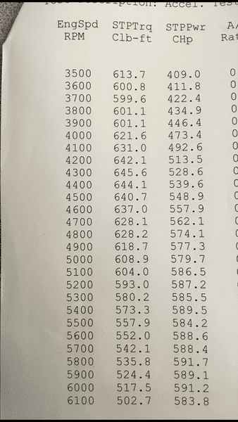

Here is a 505, Stage 1 RPM heads, XS290S cam, 1.5 RR, 6bbl.
About the same TQ as yours, but doesn’t carry it as well with the dual plane and lesser flowing heads.
Still hung on pretty good to 6K.
What sized headers were you using on the dyno?
Too small and it’ll def kill off some top end.

The reason why we pulled from 3000-5500 is because the engine is brand new (minus heads and block) so we brokein the cam and rings and when we started making pulls he set the load at 3-55 to start with, but when the engine didn´t make power above 5300 there was no point in increasing rpm (i still wanted to pull it 6K) It was a 1 7/8 dyno headers, i run 2" fenderwells in the car.
