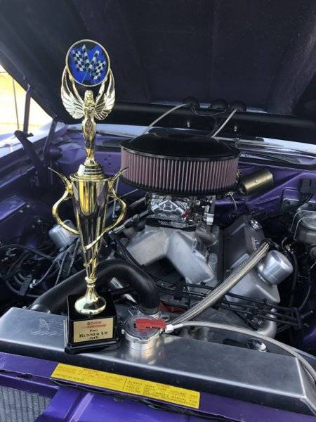

Motor appears to be sealed well. Not much in the puke tank. Old 511 and 440 both had to be drained every couple rounds.

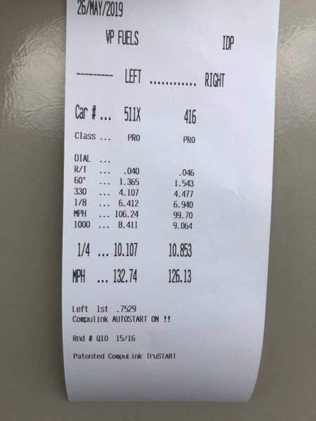

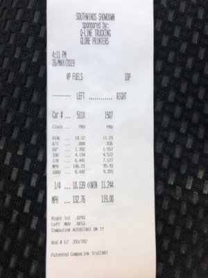

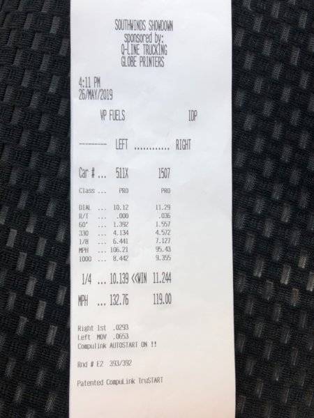

Runner up. Broke out. Dang.
As the track got better I did dip into the 1.43 then 1.42 60 foot.
Also the motor used way less fuel than it normally does which tells me either the QFX 4710 is more efficient than my AED, or the porting on the Wilson Manifold not only helped power, but also in fuel distribution. Or perhaps a combo of each? Regardless whatever caused the change, it was noticeably different. I went 8 rounds and from past experience I’d have used Way more than I did. So that is a win right there.
Will cut the filter apart sometime this week and run the valves to make sure all is still good.
Last pass was a 10.31 on a 10.34. Took the stripe but also took a nap on the line. In the final no less. Oh well something to build on.
