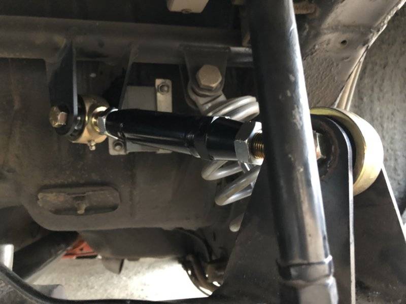

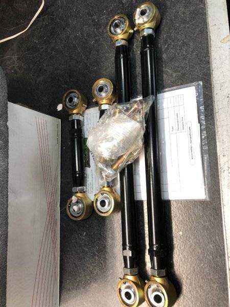

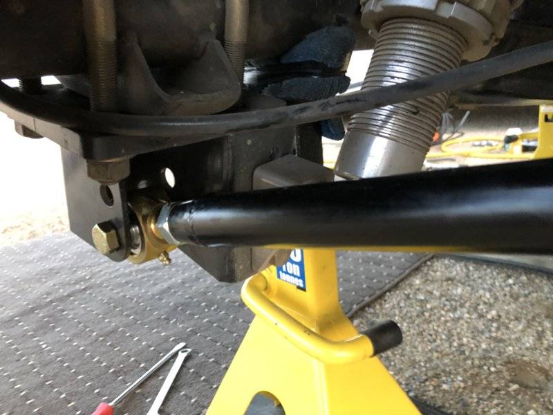

New 4 link rods for my street lynx. Will collect from Malex tomorrow at the track and put in the car after racing Saturday. See if there is a difference from the old bushing Rods.

Will be interesting to see, I got these for my street lynx also.

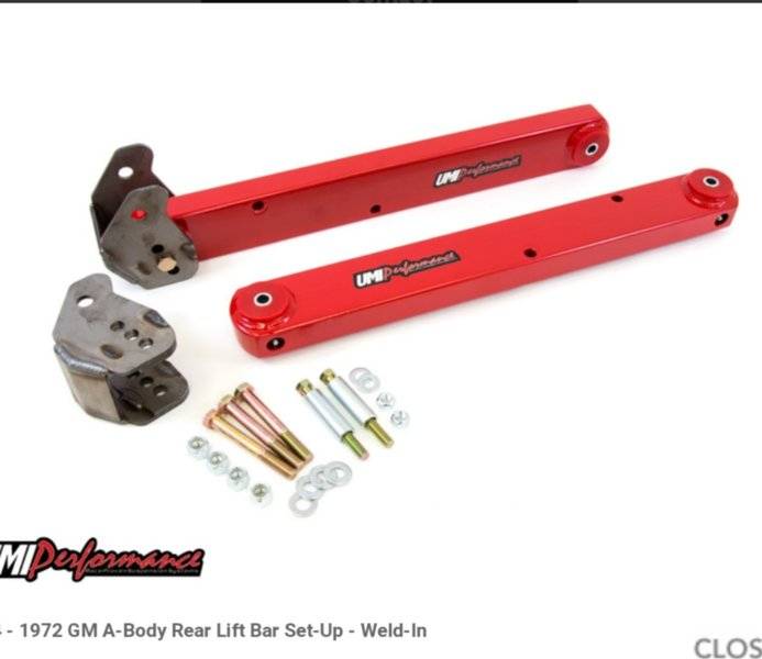

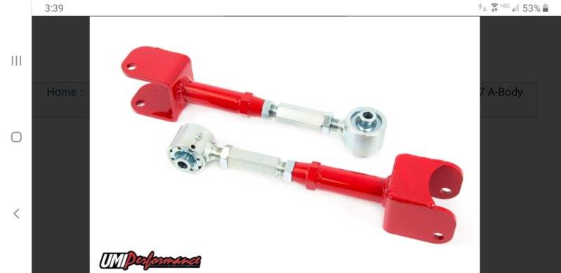

Wookie, do you think I should go with the type of control arms you just upgraded to from the get go when I install the triangulated rear suspension?
I used these for the UCAs on the Quick Performance Ford based 9" rear axle assembly in our 65 GTO. Top of the line UMI w/Roto joints:

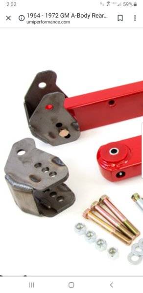

We used lift bars to replace the lower control arms, and Quick Performance is welding in the adjustable lower brackets that go along with them. At a glance, the brackets look similar to the lower brackets you have. Different bolt hole mounting points to adjust instant center.

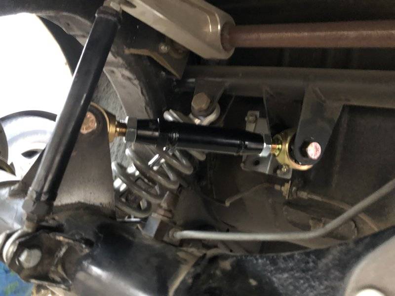

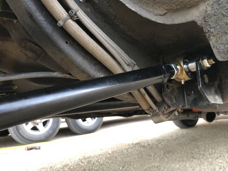

So melted the tires off in second round today. The track went away. Many were complaining. That said, I did notice the initial strike after letting the button go with new 4 link rods more solid. No more spongy feeling. So I probably need to tweak the shock settings a bit. I wish I had video to show but I don’t.
Maybe a couple of clicks less compression in the rear? Not sure.
That said. The last pass Saturday night the car melted the tires off with the old 4 link bars. So thinking mostly a track issue not a rod issue.
Can sure notice the rear is much more solid when turning.

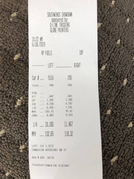

The first pass this morning the car did 1.38 60 which is 1/100th better than the rubber bushings were yesterday.
Car went straight. So that’s good.

What are you doing with the car? Street or strip? 4 link good. Especially if running street.
Like Malex, I probably would have done ladder bar had I known I would just be racing.
