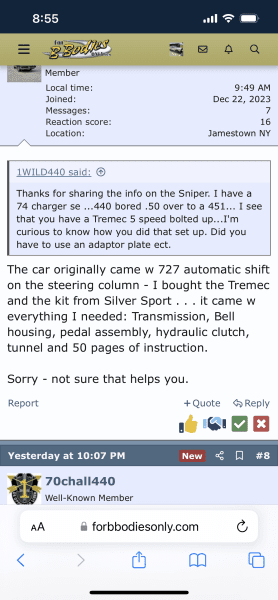

This is the only correct answer if you’re starting from absolute zero. And, as mentioned, there isn’t near as much cutting necessary as what used to be.
This seems to usually go the same way. Guy gets a quote for a 5-speed conversion package. Guy sees the “high” price. Guy thinks he can piece together something cheaper. Guy spends months piecing together a conversion that ultimately costs more time and money than a TKX would’ve been. Guy claims he put his conversion together “on the cheap” but really knows the truth.

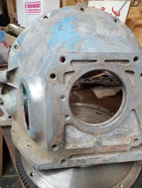

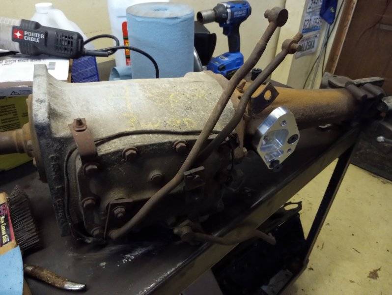

I bought an aluminum O/D trans and bell housing from an F body for $350. Got a new trans hump from a forum member for $150.

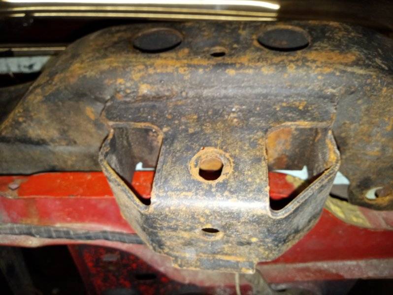

Converting an automatic trans cross member to a manual style. (Somehow the words "trans cross member" give me the heebie jeebies today but didn't just a few years ago...I digress).

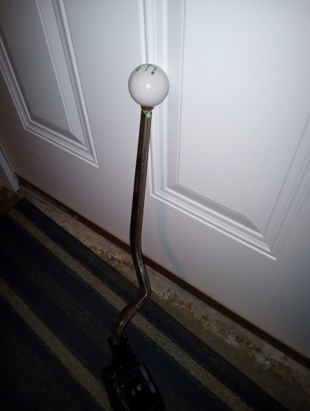

Bought a used Hurst shifter on fleabag for $75... I'm using the shift rods that came with the trans.
Found a used Hurst shift lever with patina that matches my car for $50.
