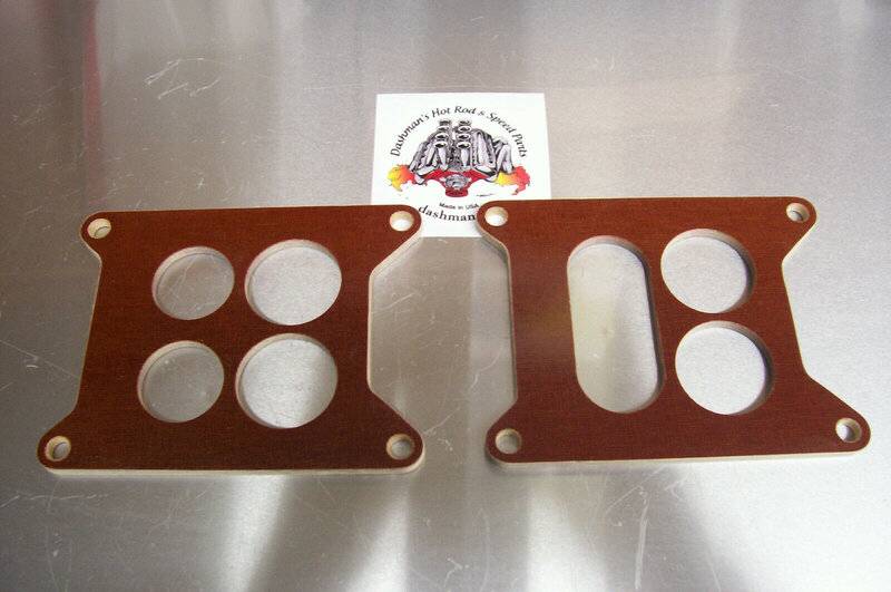

use some phenolic carb spacers between the intake and carb / throttle body

Just purchased these off eBay, I'll start with the least expensive solution and work my way up from there.
Neither the intake or the carb is Spread bore
Standard Square bore spacer would be better.
