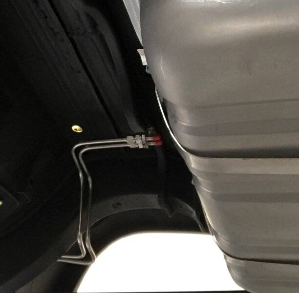

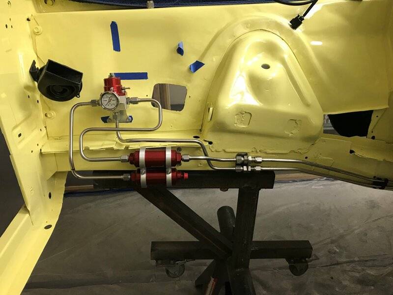

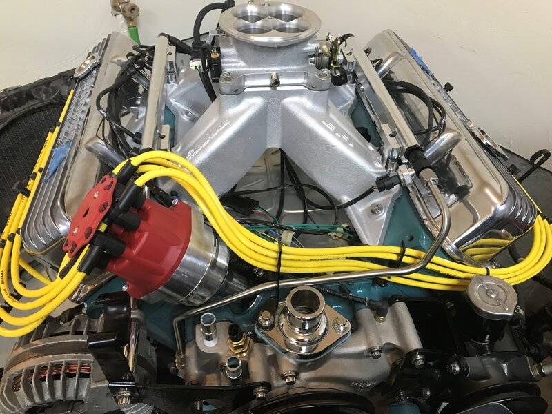

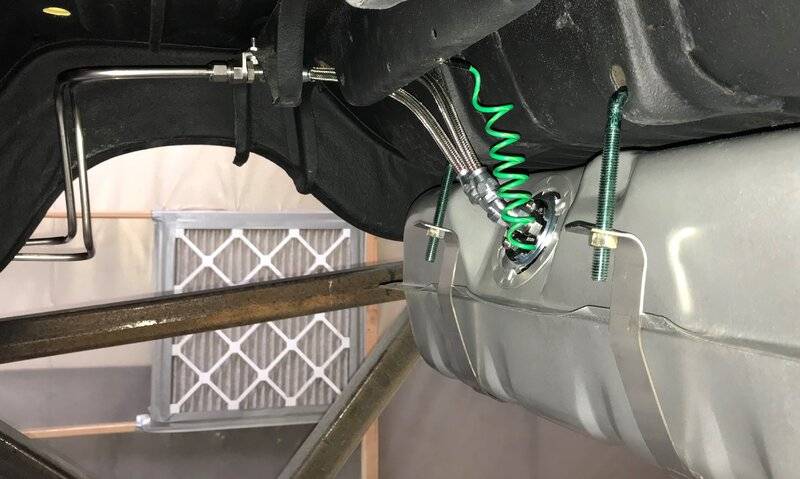

Ran 3/8 SS tubing both ways with PTFE SS braided flex line for connections. A good Ridgid flaring tool works great. The flair is actually 37 degrees, had no problems. Held 92 psi overnight. All fittings are SS at McMaster Carr and with the sleeve set up you don't need to double flair the tubing

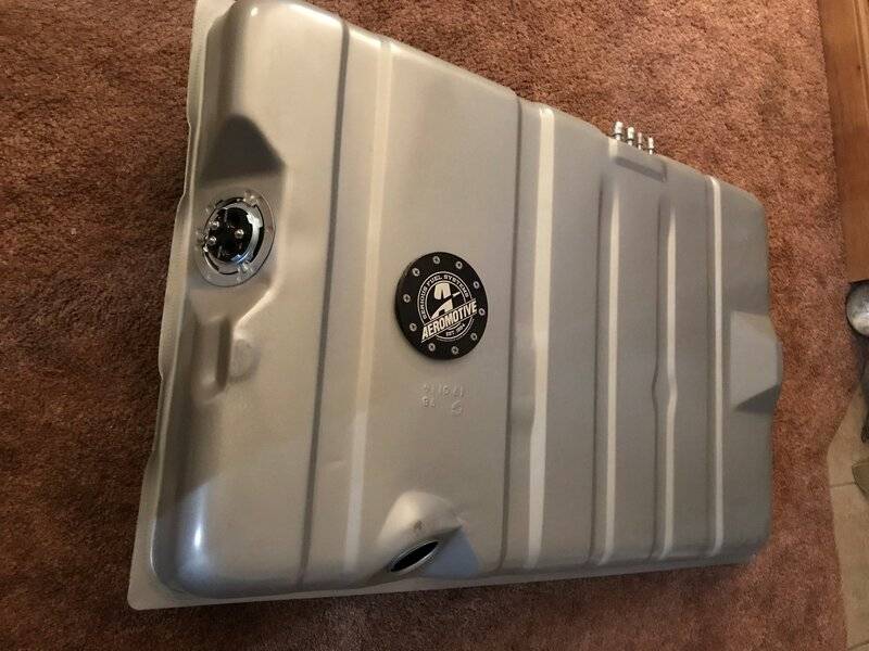

This is what I did, tanksinc and a Hyperfuel in tank pump with an fittings. Tank is well worth the $. No thank you on the tanksinc pump with npt fittings, all they offered at the time.
