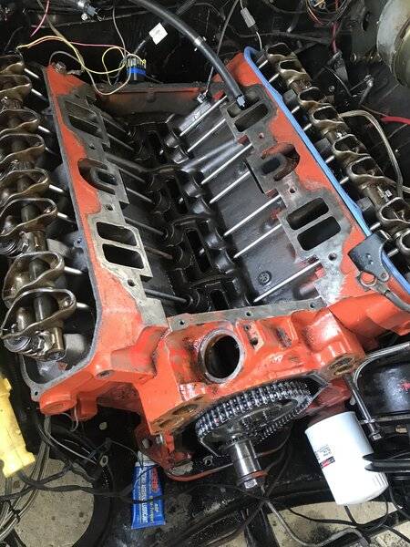

Also did an in car cam swap at the same time. Still in the process so its not pretty in the pictures. And after I installed the cam and broke it in I then installed the Hyper Spark just because I didnt want to hunt for settings to get the cam broken in. Hyperspark not installed in these photos.

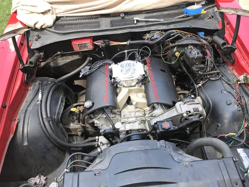

Holley Sniper on a 5.7 Corvette All Aluminum engine.

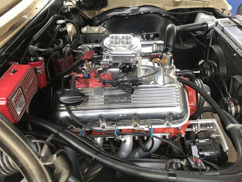

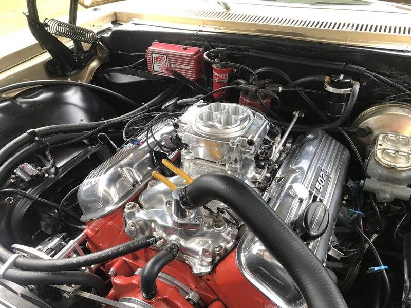

On a 502 Big Block Chevy

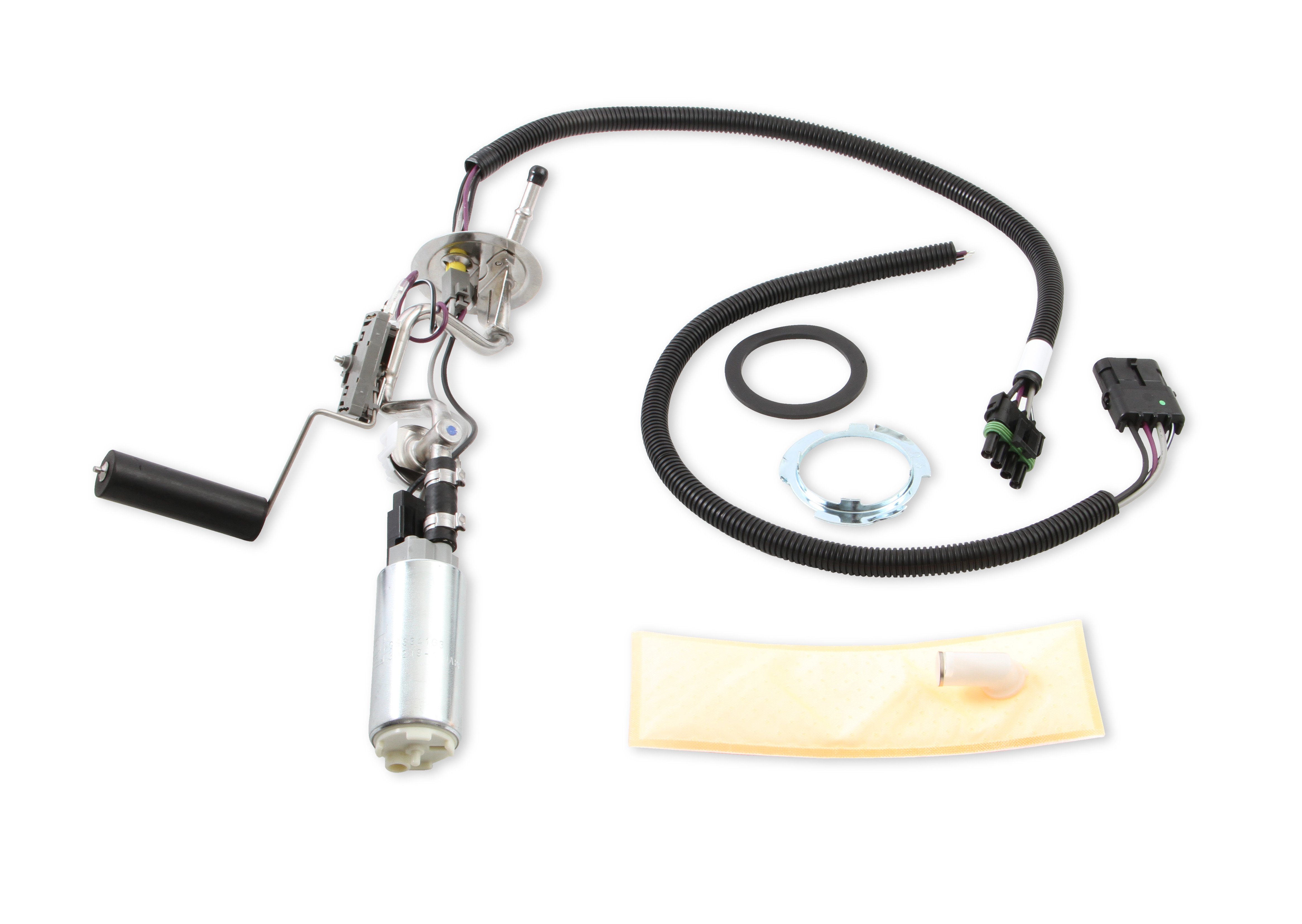

To be more precise On the last Sniper I installed he was going to go with an EFI tank but Holley makes a direct fit EFI sender. It installs in the original hole and no need to spend huge amounts of cash. Also with the Holley In tank sender no need for a return line. You can use your OE metal line and just swap the old rubber parts to EFI hose. You dont need to invest 900.00 for an EFI tank. The in tank sender is around 300.00 I think. I will see if I can get you a link to it. HERE it is.
