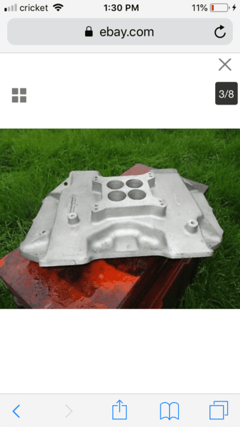

And then there’s this thing on ebag right now....... something ancient from Weiand....... before my time.
If it was cheap, I’d buy it just to dyno it on something down the road.

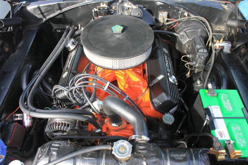

My 69 GTX with 440, performer rpm intake, and drop base 2" air cleaner with an eddy 750 carb. About 1/4" clearance to hood.
There’s a few original Torkers and CH4B’s on there right now.
That thing is interesting. I’ve never seen one in all my years of being in this hobby. You’d better hit “make offer”!!
