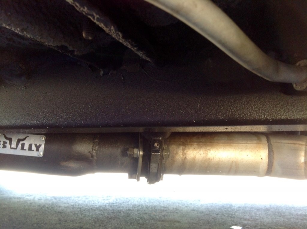

Lousy picture, but wanted to mention that I put Bully megaphones behind the Quick Time Performance cutouts. Without them, it was a more aggressive raspy (angry) sound. To do again, would not use them. With a higher compresion car they are ourtight Bitchin.
