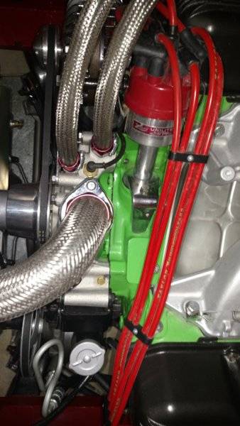

For those of you that are running electric fans, How did you run the temp sensor?
I am considering a swap to electric fans but I don't want to lose the Temp Dash gauge
This picture shows the factor temp sensor and the plugged hole on the oposite side of the radiator hose
How do I run the wiring and sensor for the electric fans?

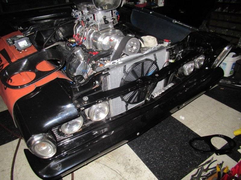

Mine is on 2 switches for 2 speeds going through relays.I prefer manual operation.Now I have a single pusher.:thumbsup:

@andyf had an adapter that goes below the thermostat I believe on one of his cars and has a port to install a temp sensor or temperature switch. A pretty clean solution.
Many of the factory cast iron water pump housings had an extra pipe plug that was unused in many models.
