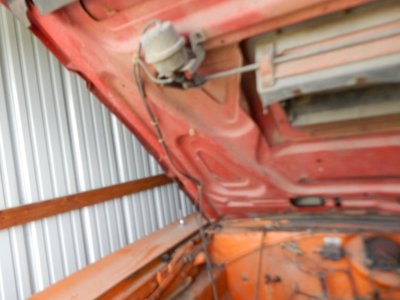

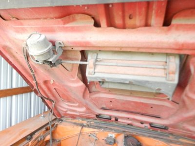

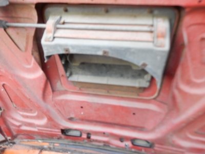

Well, I've found a stepper motor at a local harbour freight type store up here in The Great White North. Now I just need to start fabricating a mount for the door. Anybody have some straight on perpendicular shots of the airgrabber hood and how the hardware fits underneath? I need to figure where to mount the motor and the door opening hardware too.

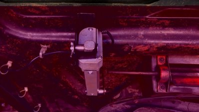

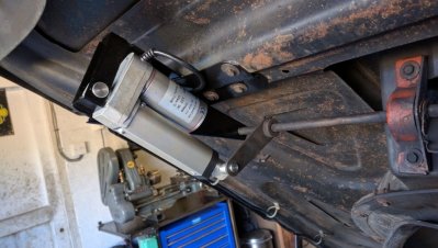

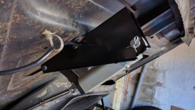

I got fed up of buying vacuum actuators from China that last a few months. These actuators are dirt cheap off ebay, just had to make a new bracket. I had to space it over to clear the 26" radiator because they are a bit longer than the vacuum unit.

WOW! Great job fabricating that setup! Do you have a drawing for the bracket? I'd like to do the same.
